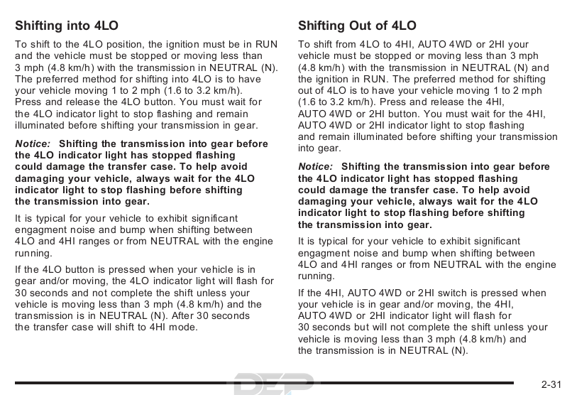

I sthe light flashing on the Tcase button(s) once vehicle is started or is there a solid light? You should be in neutral (trans) and in neutral (tcase) and not moving when switching from 4 Low to 4hi or 2hi. Did you shutoff vehicle while in 4 low? Or is the light just indicating that its in 4 low (AKA Lost).Good evening. I have an 04 Tahoe z71.

You would know if you were truly in 4wd low at even city driving speeds. That transfer case would be screaming and your RPM's would be pegged out. You likely just have a bad commutator ring in the shift motor of the Tcase. So the system is lost because it doesnt know what Tcase range selection you are truly in. No big deal, just annoying looking at the lights on the dash. Tcase is electronically locked from going into 4Low without being in neutral at tranny and neautral at Tcase. This is what the part looks like and it is located in your shift motor which is bolted on drivers side of your Tcase just behind the front driveshaft yoke. https://www.rockauto.com/en/moreinf...5UhVp0H1PmlUUfxLzmw/vwJrK0d3/XC/jsWojWDHoKHHMNo sir. I haven’t found a reason at all for needing to put in four wheel at yet. I appreciate your answer for being as complete but easy to follow for a shade tree as myself. I believe it might be not actually in 4 at all bc sometimes it doesn’t clank when engaging even after switching back to 2(if actual in 4) n sometimes when 4 auto light is on I do have to go to four high before it will attempt to switch to 2. Main concern here also is I’m able to fix it so I’m not driving in low or even high but wife doesn’t like the idea if she ever uses it that she might not be able to get it back out n knows driveing in 4 low or high at certain speeds will damage truck. Is there a way that I could just leave it in 2 and unplug something to keep it from ever going into either unless done by me. Thank you very much for the information sir.
