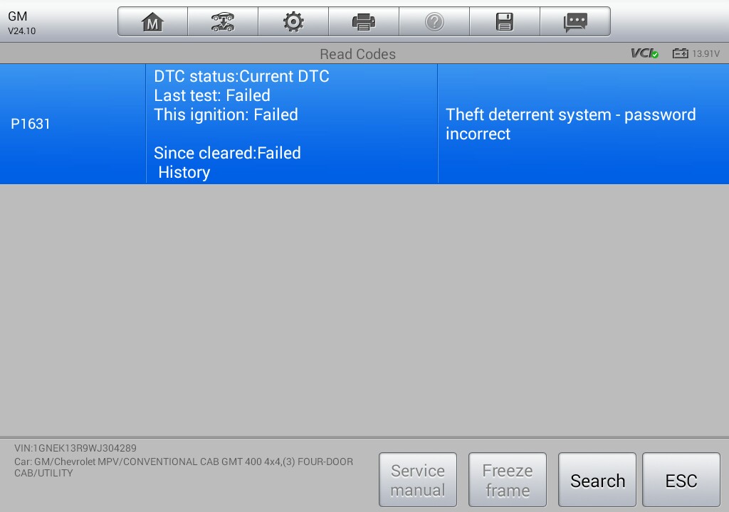

13. STILL has crank/no start issue. VCM has DTC P1631 "Password Incorrect"/ VCM still not activating fuel pump & injectors.

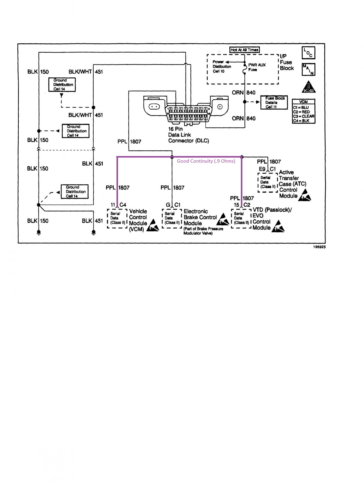

15. Verified continuity on circuit 1807 data bus between VAT and VCM. Continuity is good (0.9 ohm)

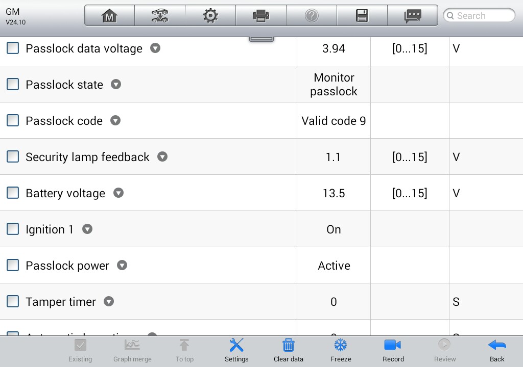

At this point I have no clue what could be going on. The scanner says VAT has valid code, indicating password relearn was successful, yet VCM still reading incorrect password. Anyone have any ideas? Thank you.

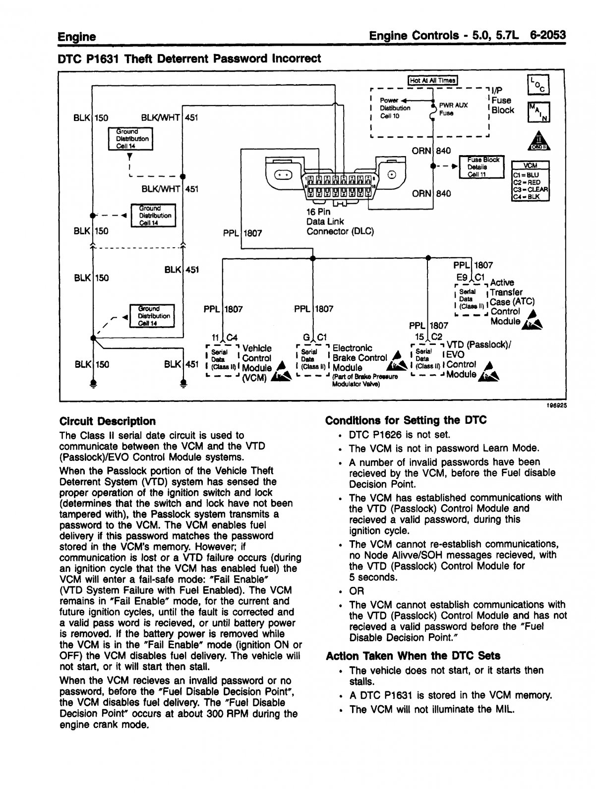

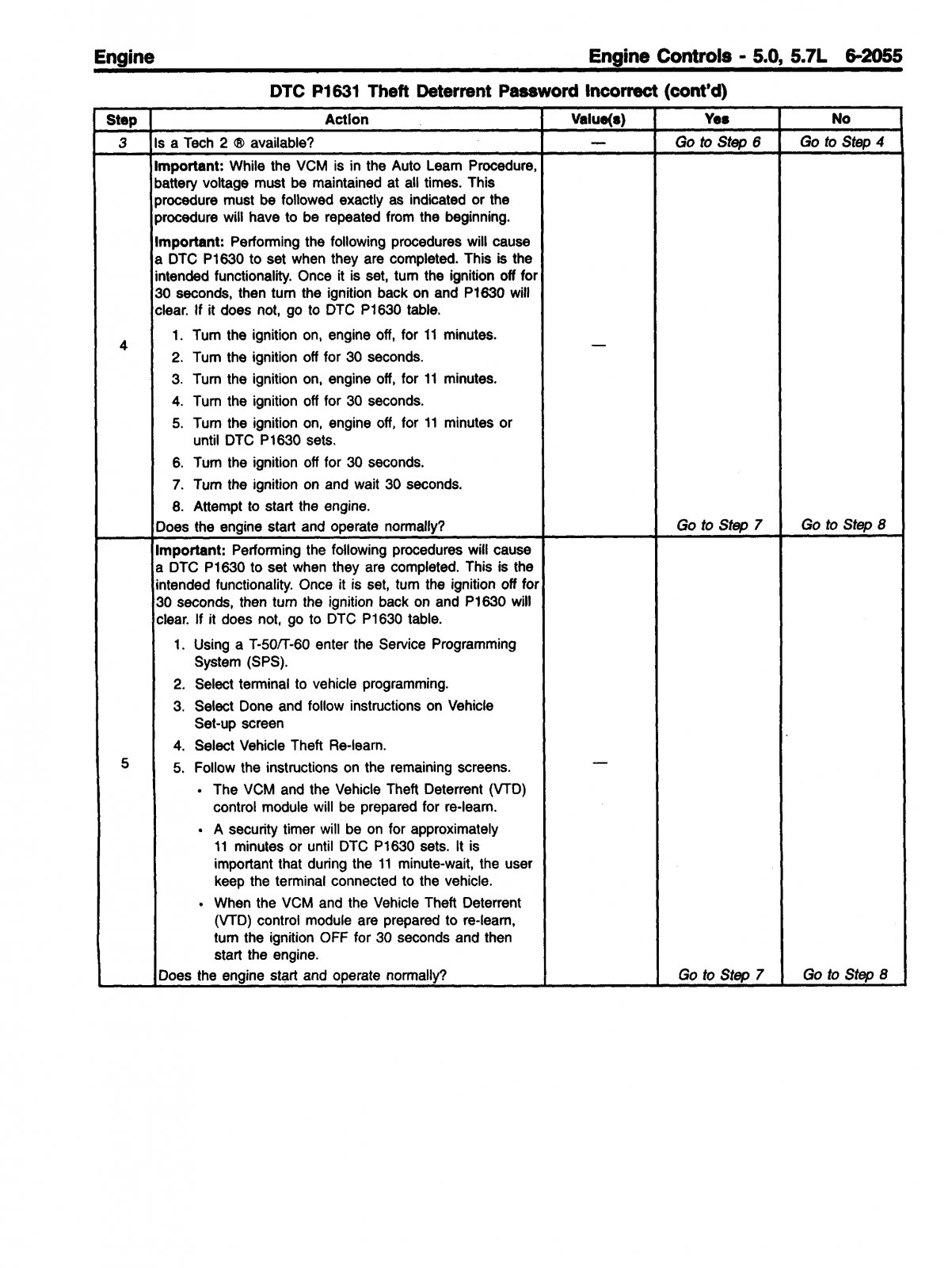

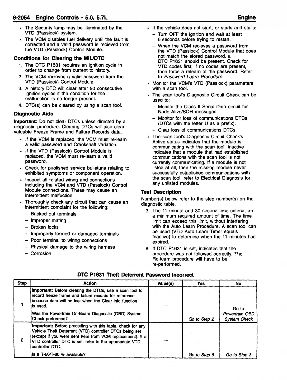

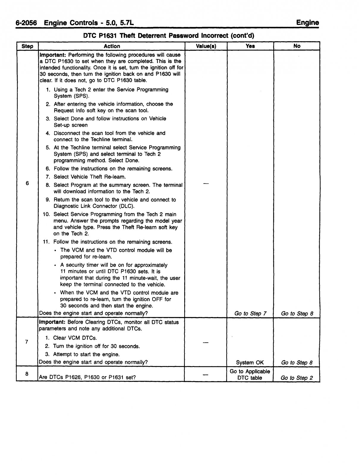

Have you run through the P1631 diagnostic in the manual? Here it is for 1998. It may be the 30-minute relearn that you mentioned, in which case the manual appears to just go in a circle if that doesn’t work. It does have some cautions about maintaining battery voltage during the process and following certain time limits.

Yes. I ran through the diagnostic steps. As you said, it just runs me in circles. The relearn has worked, as you can see by the Valid Code 9 and monitor state parameters on the scanner. It's the actual VCM that doesn't want to accept the password.
