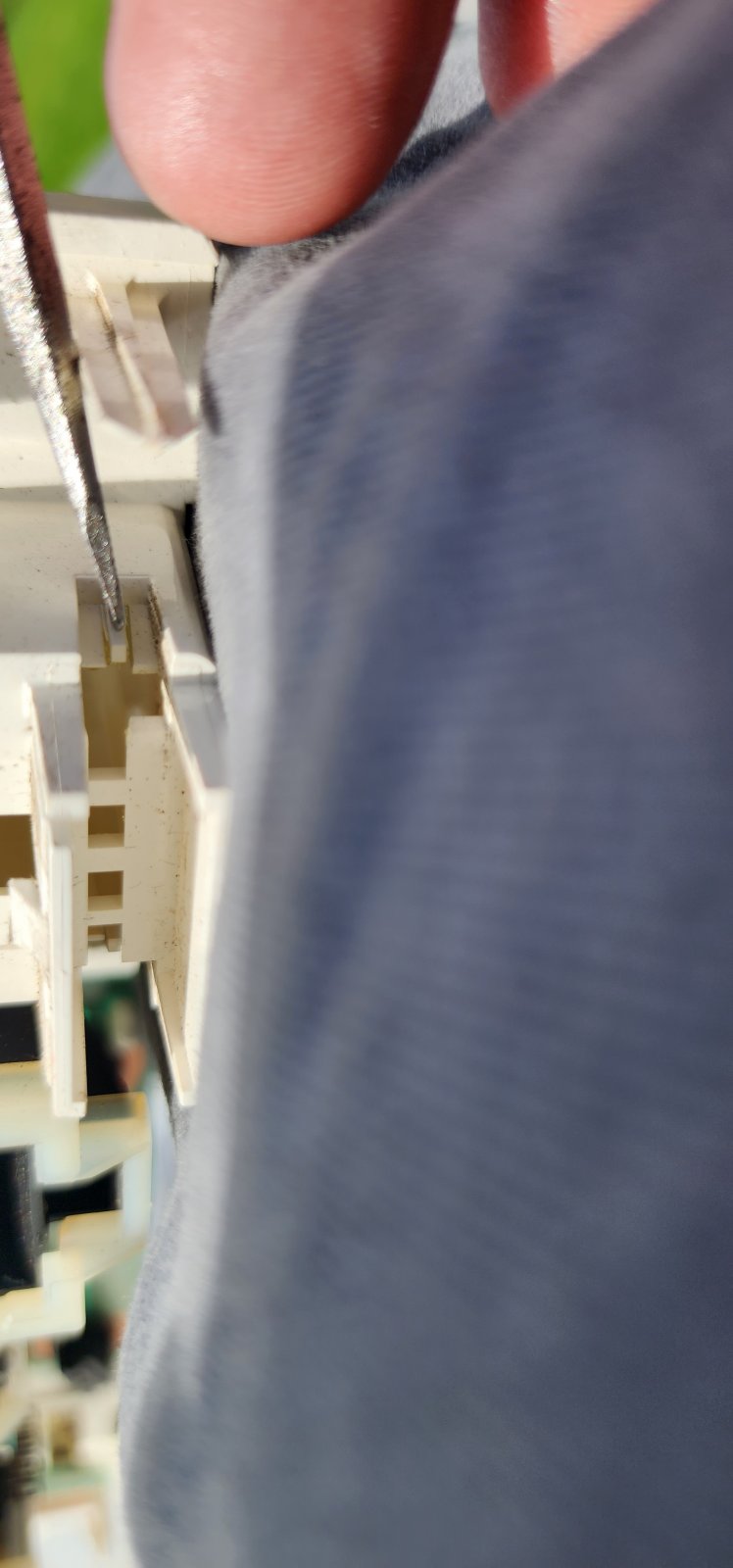

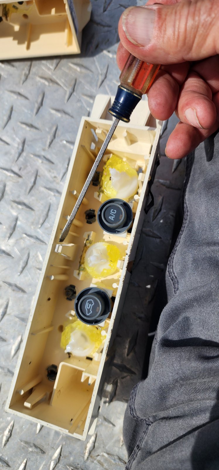

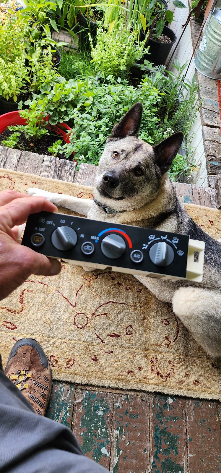

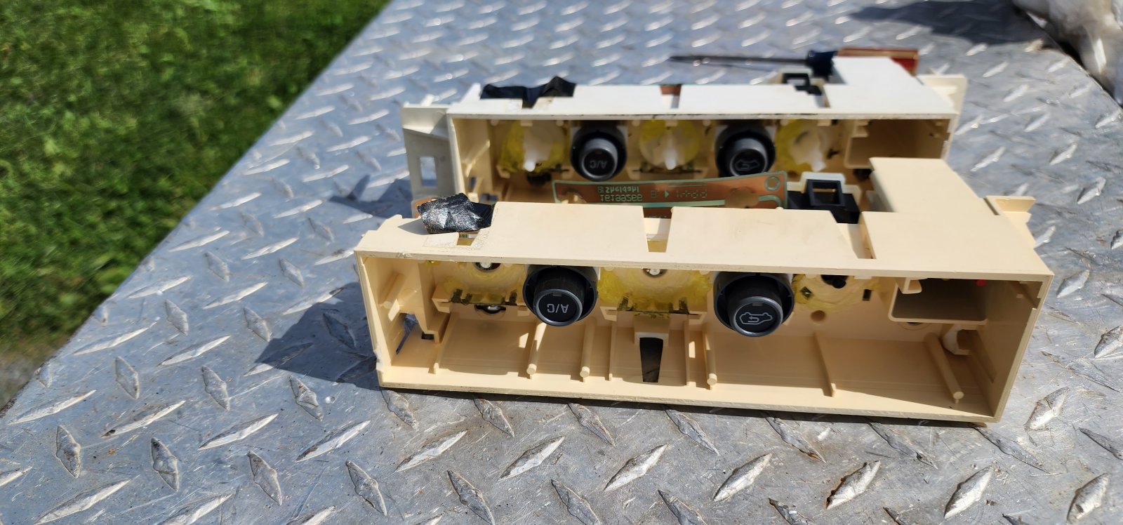

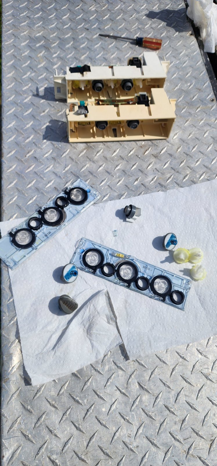

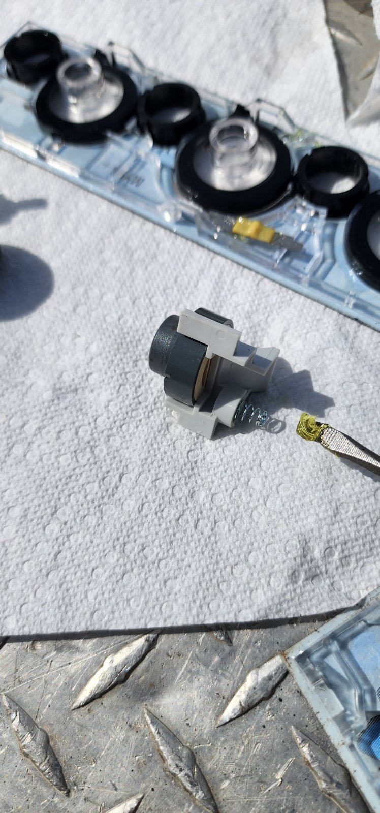

NOS pieces are priced out of sight. I'm not a big fan off the china stuff. So I did a thing. Swapped the broken case parts into the good case non rear defrost spare I had. If you go junkyard shopping find one made out of white plastic. The beige ones are too brittle. I used the little screwdriver to reach into the bottom of the tab slot, a little twist and push released the tabs. Remove the face plate, dont disturb the white switch actuators. There are two little tabs to release the rear defogger switch assy. They broke as soon as I looked at them. It will slide right in the no switch housing and latch in place. Don't loose the little spring! A dab of the silicone grease inside the switch housing will hold the spring in place during assembly. The housing will have plenty to use. Small end toward the micro switch. Snap the face plate back on and bingo.
