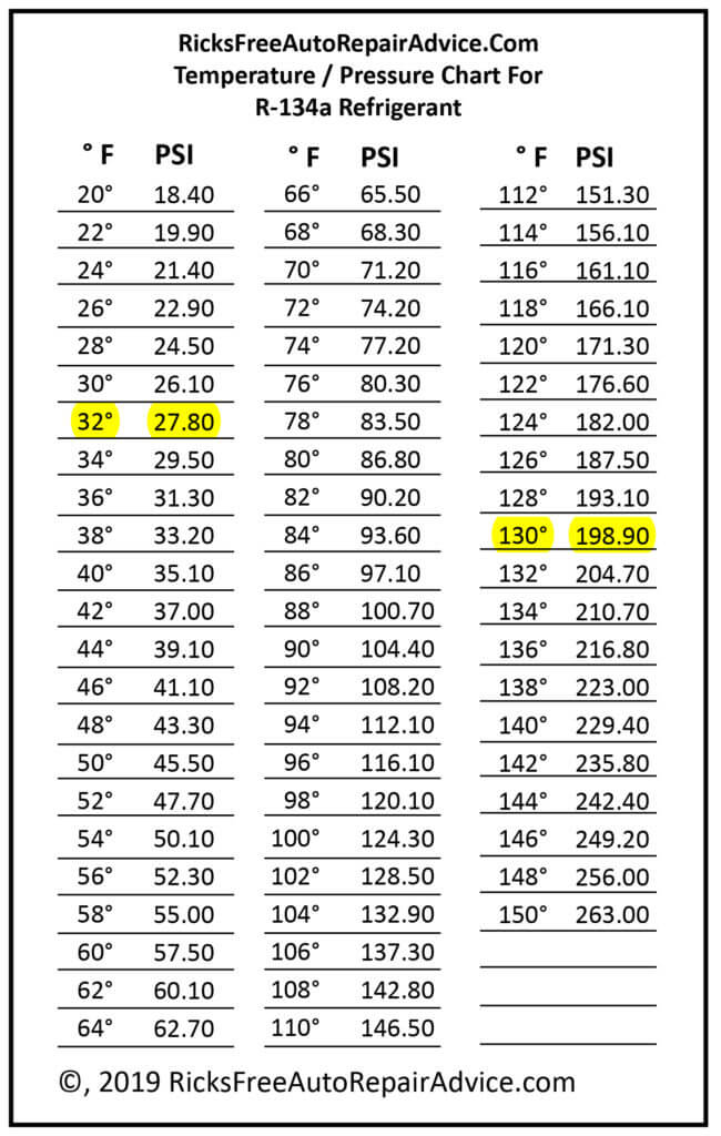

Would be better if you had hi side pressures and humidity too. As a guess, I would say you are undercharged. 27-30# is kinda normal for 65 degrees.

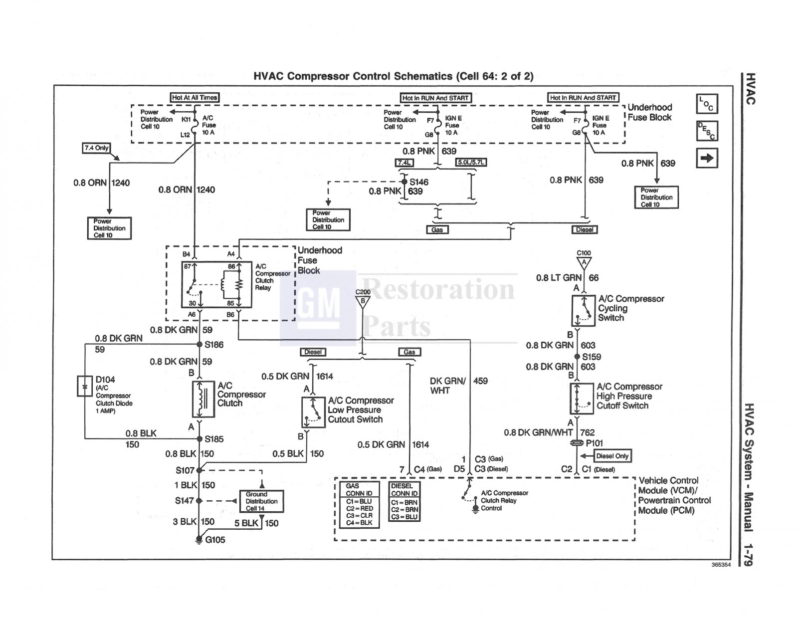

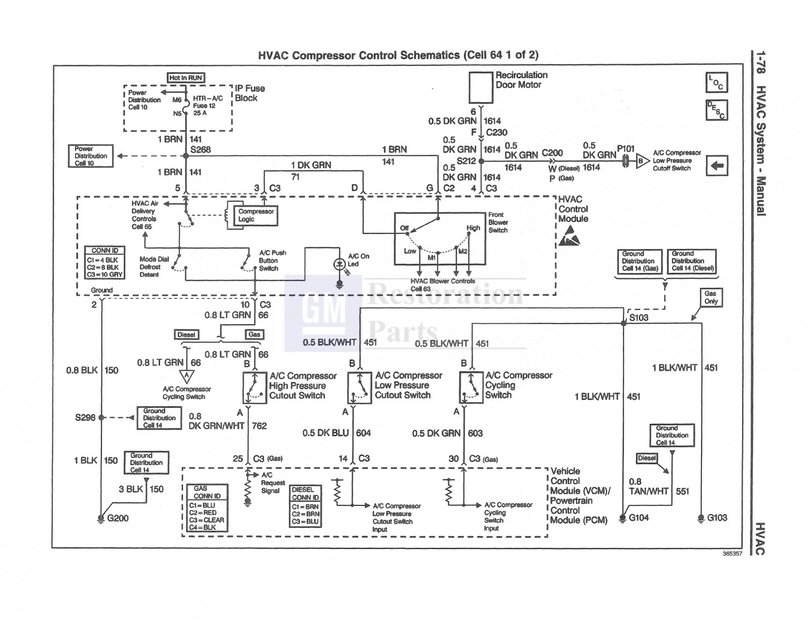

got a nother can and put it in have a solid 30 lbs now but have to power the clutch off the battery i have power at the switch on the acumilator and at the the switch mouted ontop of the compressor, but there is no power at the switch on the back of the compressor. I dont have a deacent wire diagram for the a/c system only the one that in the haynes paperback. which is foe the trucks does anyone one have adigram that is for the Tahoe? Thanks

Top of compressor is the clutch wires. Back of the compressor should be high pressure cutoff switch that provides ground. All of this from memory so it comes with a disclaimer.

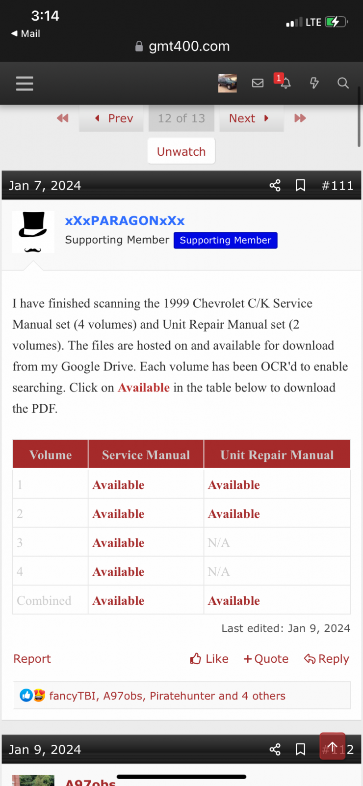

Here’s the diagram from 1999. The full manuals can be downloaded at the link below (see post #77):

Thanks for the information and the diagrams I replaced the high-pressure switch and have the other 2 on order. I’ll post what I find. went to get the downloads and it wanted me to download a game is that correct?
