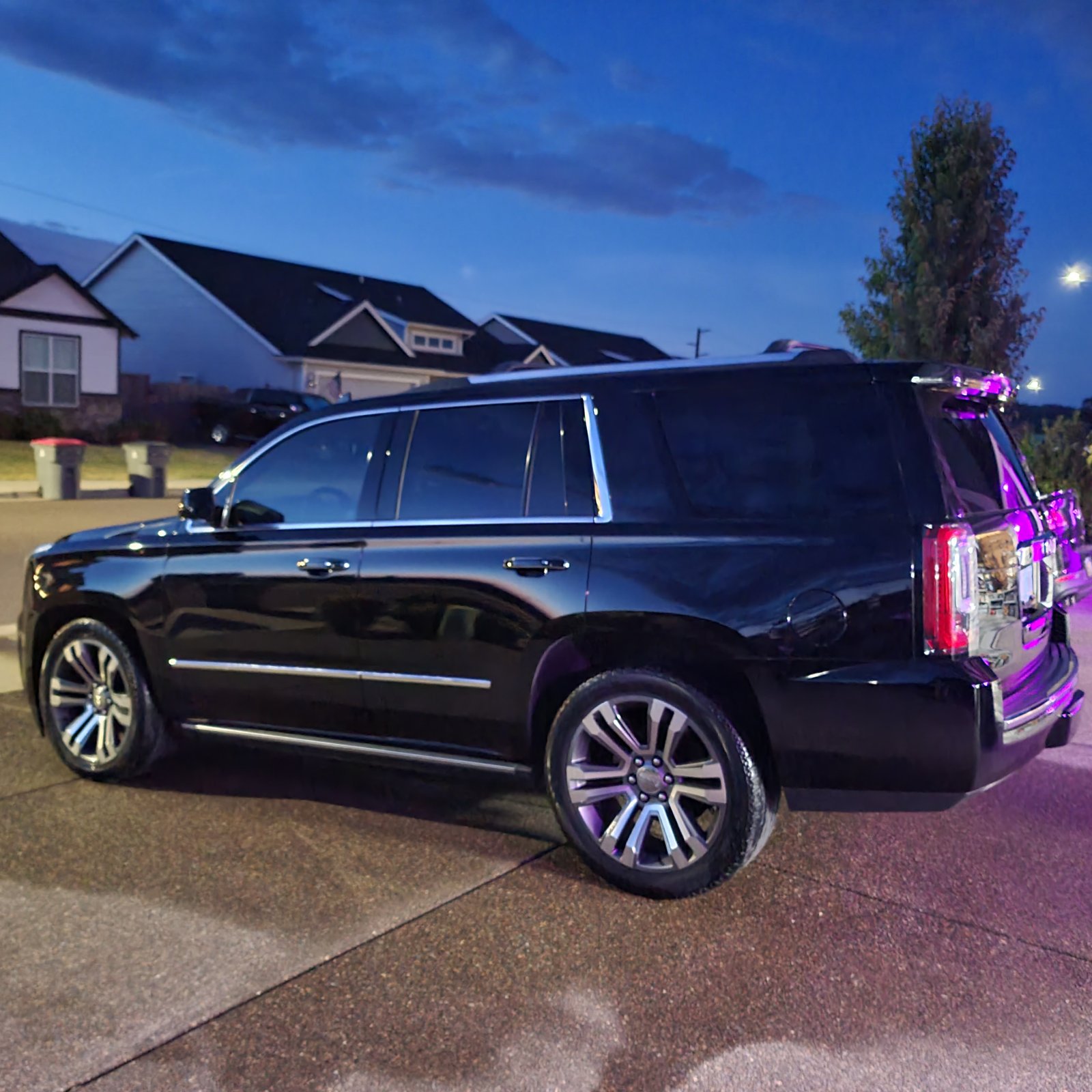

With 75K miles on the OD thought I'd start the new year out with a shiney ride. I washed, claybared, washed again with a striper soap to remove any waxes or sealants then did a full paint correction with Maguires Fine Cut before applying 2 coats of CQUARTZ UK 3.0 ceramic coating.
This was my 1st time doing a ceramic coating. It was easy to apply but lots of surface on a Yukon. From start to finish it took me about 10 hours including all the prep work.
