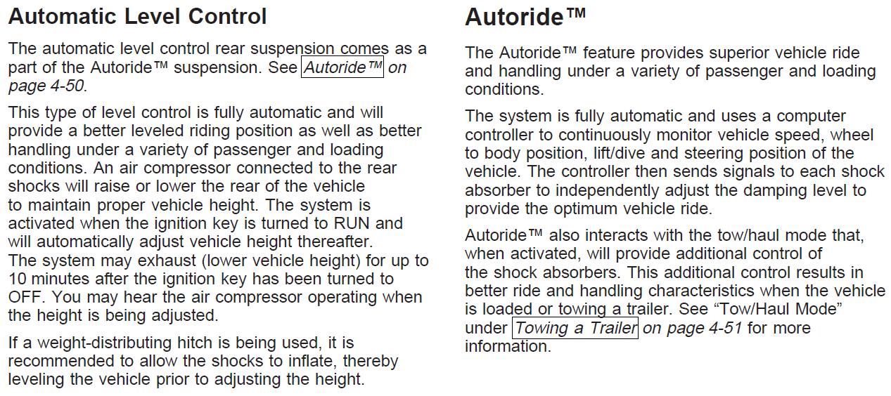

I have a 2003 denali with auto level new rear shocks (no leaks) when I hook up my travel trailer (with weight distribution) I still get enough squat that the bottom of the hitch catches on speed bumps I am looking to add some sort of air bag bump stop to stop this but every mfg says nothing available for this model does any one have any feedback?

Make sure you're using the correct procedure when hooking up a weight distribution hitch with the auto-level system.
I'm not sure the exact steps of that, as I have not ever used a WD hitch with any trailers I've towed, but I've seen others talk about it on here. @swathdiver @Geotrash

some people just put helper bags inside the rear springs then run a airline out near the license plate so you can fill/empty as desired, relatively inexpensive solution that works well
