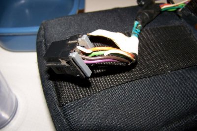

It turned out to be a broken WHITE wire from the brake light switch pigtail where it goes into another connector. I had to pull the steering column to remove that pig tail. Where it plugs into the otherr connector it's attached to something that holds the pigtail up off the column. The WHITE wire was severed right where it plugs in to that connector. There's a sharp metal piece cutting the pigtail wires. I believe it was also due to the extended travel in my brake pedal which is caused by air in the anti-lock system. It scraped the pigtail over and over and since it's fastened down at the other end it final broke a wire by cutting into it. Two other wires are also cut through the insulation. I don't think it would've happened without the slop in my pedal.
The fix is to repair the wire, move the connector to allow more travel and get all the air out of my brake system. I wish I hadn't allowed the mechanic to suggest replacement of my master cylinder.

I have had the problem with my brake lights only coming on when i mash the pedal to the floor. I replaced the brake light switch, and then I lost my brake lights all together, then realized that I had also lost cruise control. I found this forum, read your thread about the wire being damaged next to the connector, with a nice picture. So I contorted under the dash with a headband light, and sure enough! damaged wires. The only things that I had to remove was the screw holding the wire cluster directly below the steering wheel, and the brake light switch. It took about an hour to get it out, I soildered the wires back together, then covered them in heat shrink, and reinstalled everything in about 35 minutes. I cant thank you guys enough for your time and valid information.
