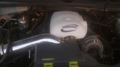

On the modern mouse build that super chevy did they got a junk yard 5.3L, stroked it to a 383, twined it and it made 963hp and 868 ft.lbs. at 12.8 lbs of boost. So if my build ever gets close to that id be one happy ass camper. You can look up all the things that they did to it, it really made me have more confidence in the 5.3, saves a lot in the long run i think being able to use this motor rather than having to get a newer bigger one. Im even more stoked because this motor has way low miles on it, so its a good platform to go off of.

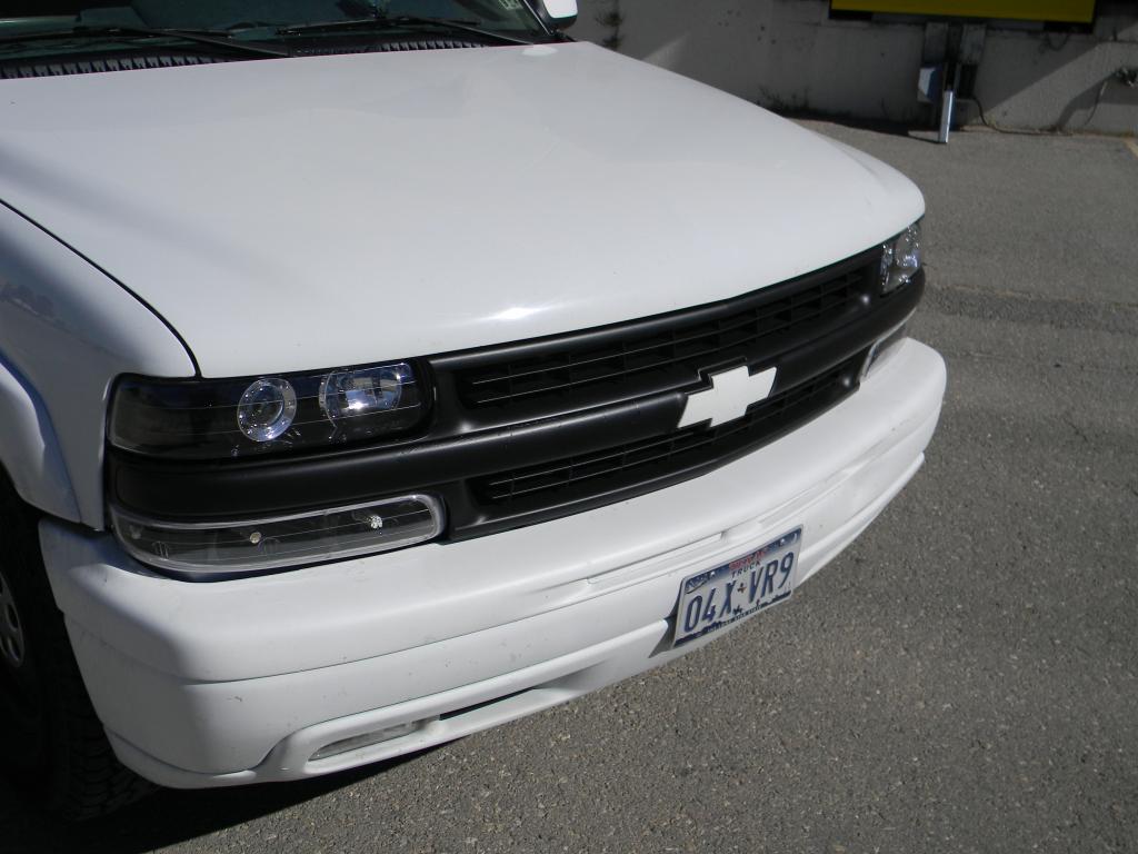

After the stall and cooler I want to do a retrofit because my PnP kit is pissing me the hell off.
