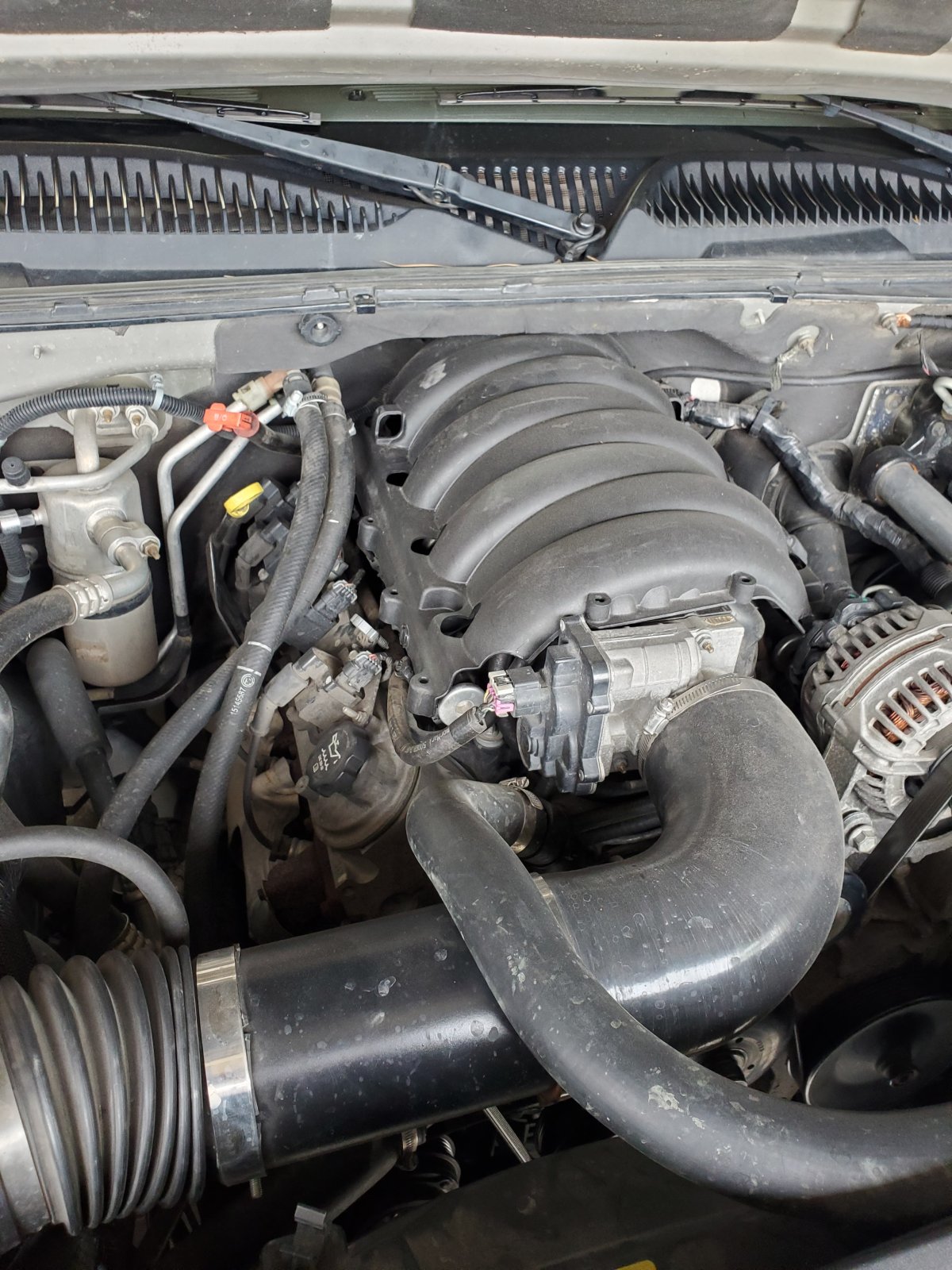

I've tried diff ones on my Yuk and on several other cars over the years.
I finally decided on the MIT tube only for the Yukon...
The OE filter box IS A CAI !!!! I have a good " green filter" in there
(it came with my supercharger that is now gone)...
I've looked at my IAT's quite a bit...
The stock box is about the best and the MIT gets rid of the clutter
from the factory tubing. It gives a noticeable sound too when you get into
the throttle
