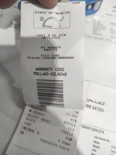

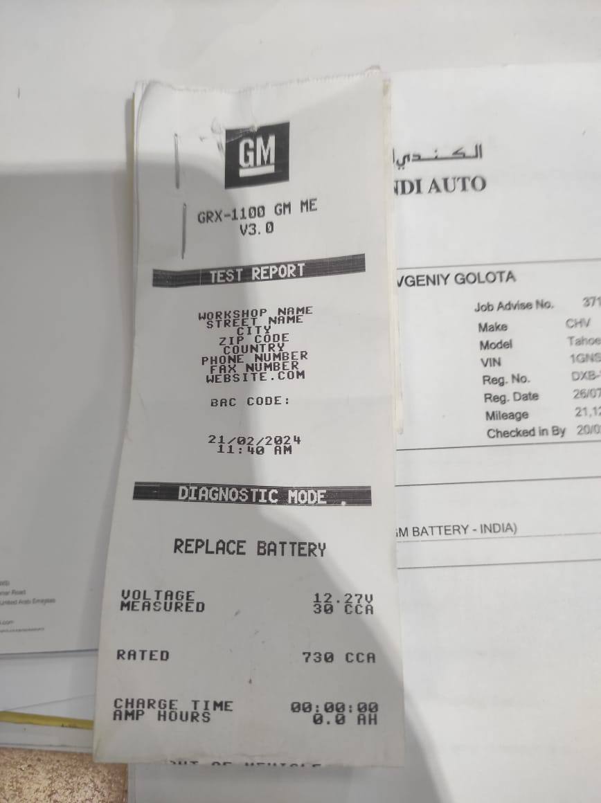

Hello all
I have update on this.
Dealer sent me this battery test report:
IMAGE 2024-02-22 19:45:24.jpgIMAGE 2024-02-22 19:45:26.jpg
How do you think, do i need to change it now?
it's strange, health is 47%, but i need to replace it (as it said in this report)
and what regarding warranty terms i have this:
IMAGE 2024-02-22 19:45:27.jpg
Because car is almost 20 month old, i need to pay 50% of battery replacement

GM specifies that when the batteries get below a 65% state of charge they are in need of replacement. It might still be under the manufacturer's warranty for free replacement. If not, get the new one and drive on.
