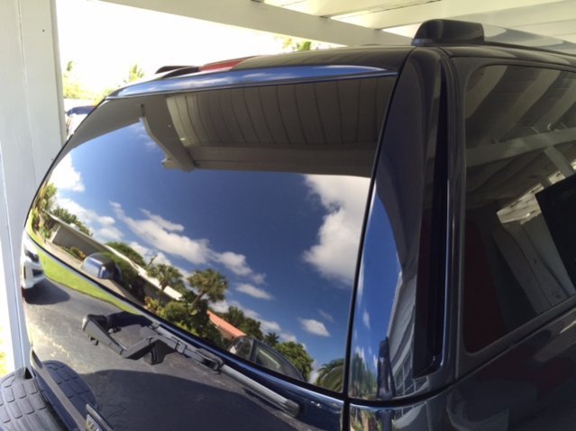

Yes or get an Esky 3rd brake light , then do the lift gate handle and push button ring just to make sure it is all sorted back there.
Esky third brake light/glass would be nice...... here is JW's Yukon with color matched housing for reference:
Fosscore
Fosscore
Apr 16, 2014
10,549
18,385
Right on. That looks really sweet. Hmmm....
Fosscore
Fosscore
Apr 16, 2014
10,549
18,385
Thank goodness I continued to read all the comments as I was just going to suggest to do this. :)
Thanks for the comment.
I've got an LS, so I've got to do the color matching myself, but seeing your pics, makes it look really good. Guess it's time to order some more paint. Thanks.

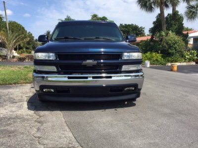

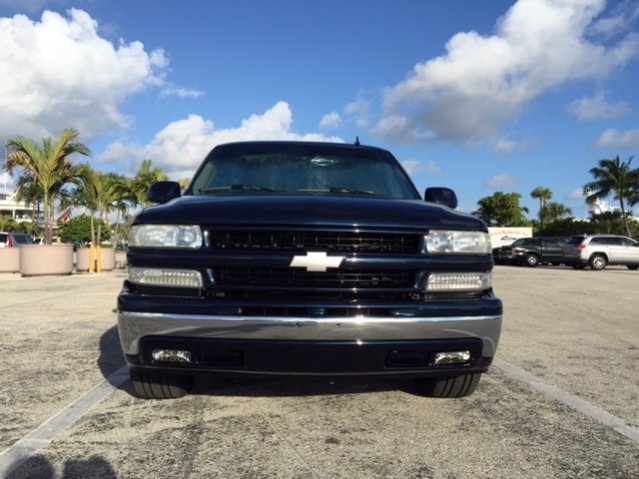

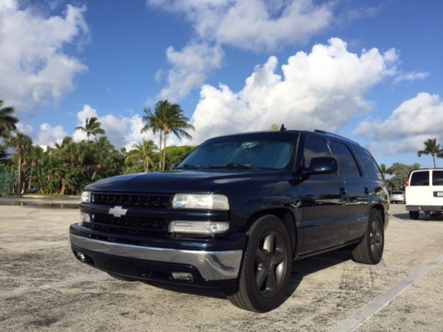

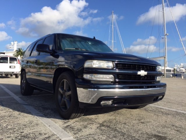

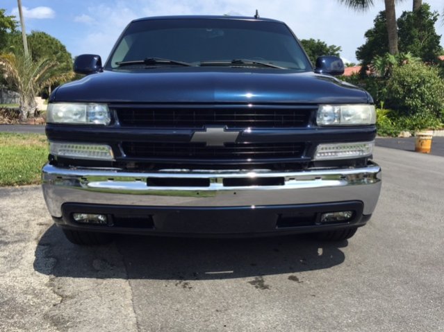

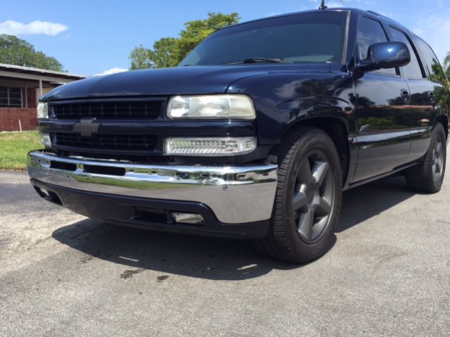

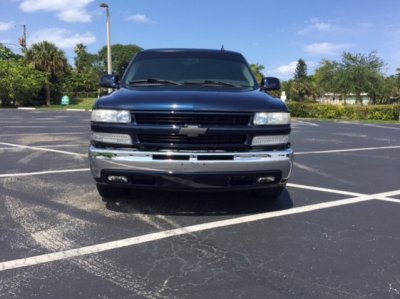

New LED Front Parking Lights
Tired of looking at my cloudy and ugly OEM front parking lights. A full retrofit would be good, but not in the cards right now. Those ck375s are still calling.
Decided to ebay shop for some front LED parking lights. I found a set in all chrome with LEDs and no amber reflector (I know technically not legal, but I figured I would push the limits just a bit).
4 days Fedex ground shipping from California. Well packaged. Direct fit without any modification. Actually had to type in Silverado 99-02 as 06 Tahoe did not yield any results.
The wiring harness male plugs fit snug into the OEM female plugs and as well into the aftermarket housing openings. I had to reroute the amber power wire so that it came into the middle of the housing as that is where it plugs in, unlike on the OEM housing it is on the far outside corner. Just a simple matter of pulling the wire loom to the inside. This plug was quite snug going in, but better than just flopping out.
There is a hard wired resistor about the size of a Zippo lighter. I ended up putting 3 zip ties around the resistor to the headlight framework just behind the lights. It fit perfectly there and was tight, without impeding either housing. No quick flash was experienced and all the LEDs lit up, except for one on the far outside corner. There is one row of LEDs on top with a large reflector surface below the LEDs that puts out good light as seen in the picture below. Almost looks like 2 rows of LEDs.
There is however one mystery LED on the far outside corner where the OEM amber reflector would be. This opening in the housing is gooped tight to prevent water intrusion and there is no external wire going directly to it. I have not seen it light up yet during DRL, key fob or turn signal use. Not sure yet if it will light up or not?
Edit March 2015 - I contacted the company and they confirmed that the outer single outer LED will not illuminate. I have not had any issues with the lights, nor been put off by that single LED not lighting up. Been pretty happy with the updated look thus far.
I like the clean look (without the amber) of the chrome housing. I think it enchances my front end a bit more. Looking forward to seeing the light output at night. Hopefully the LEDs will perform well for a while considering the affordable price of $49 shipped. Definitely much better than the cloudy OEM lights either way. We shall see.
Here is the link http://www.ebay.com/itm/281105164973?item=281105164973&viewitem=&vxp=mtr
(As of February 2017, this link has not shown any more of these lights offered for sale by this vendor.)

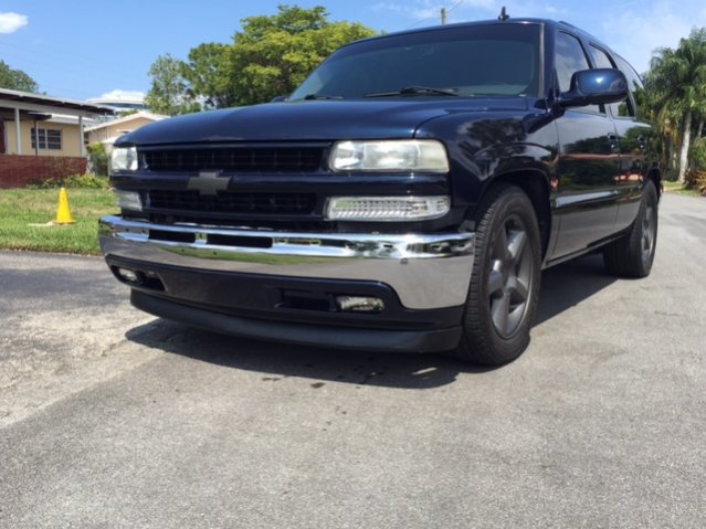

Here are some daytime photos from the install this morning before work.
