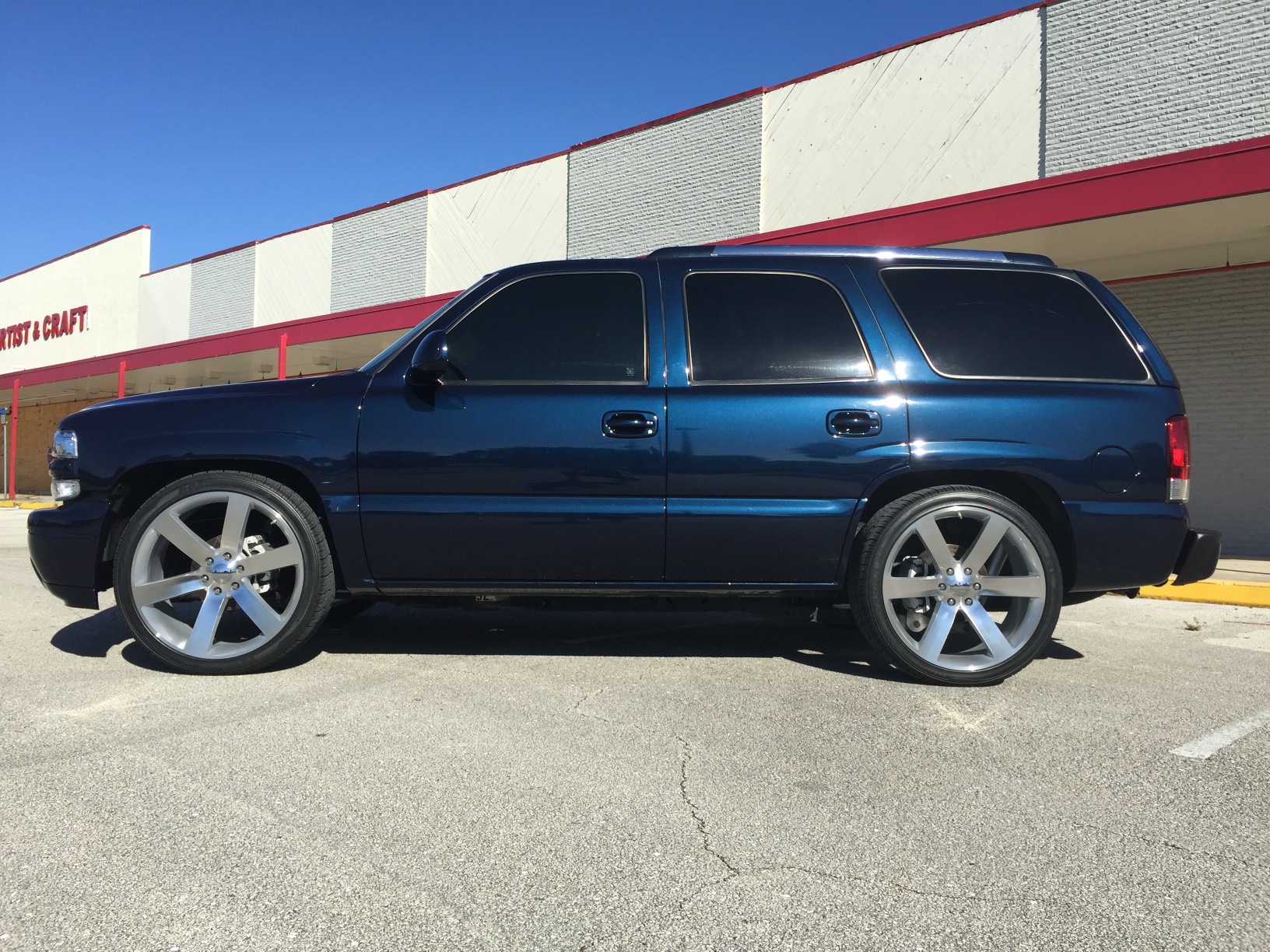

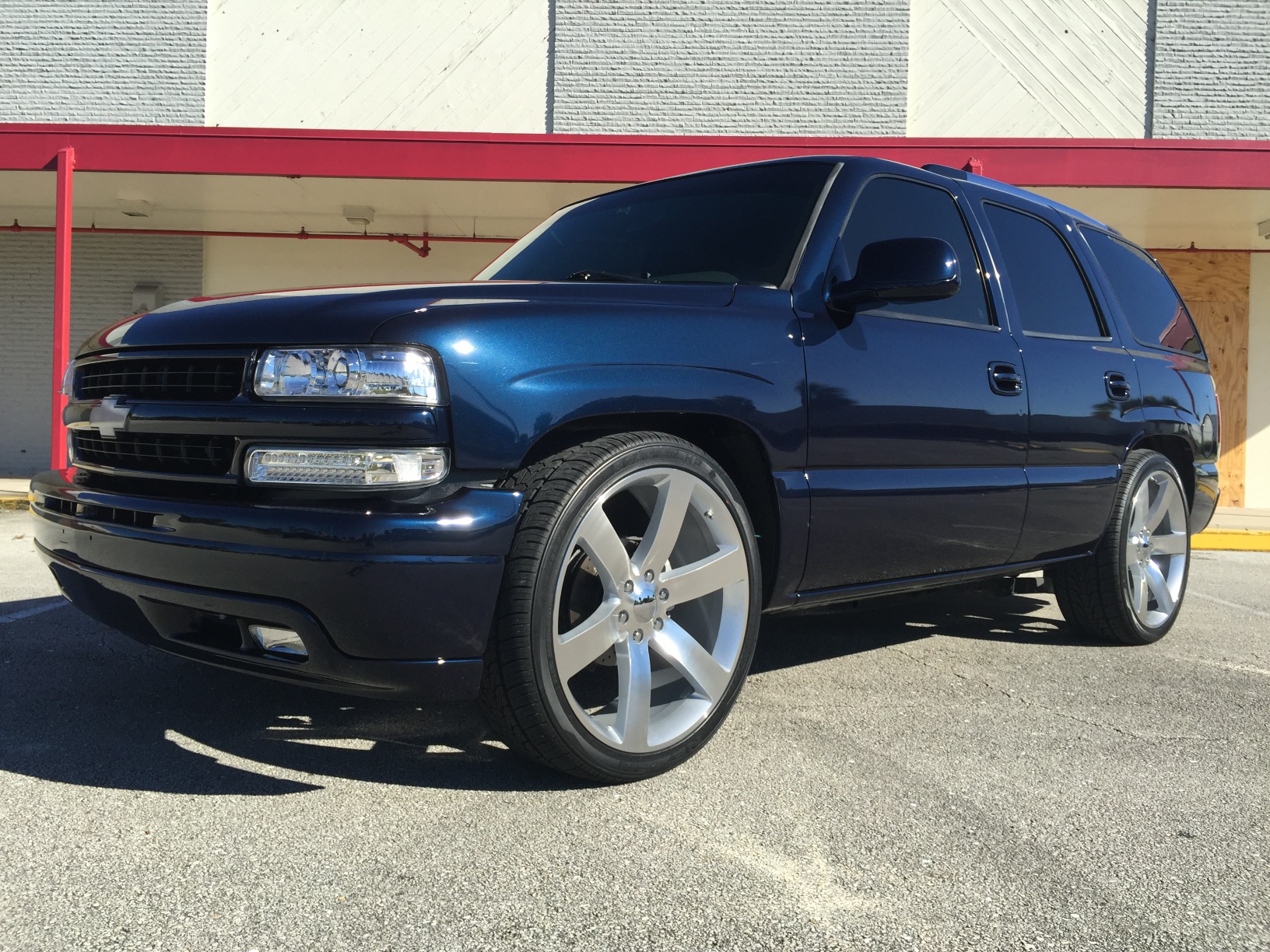

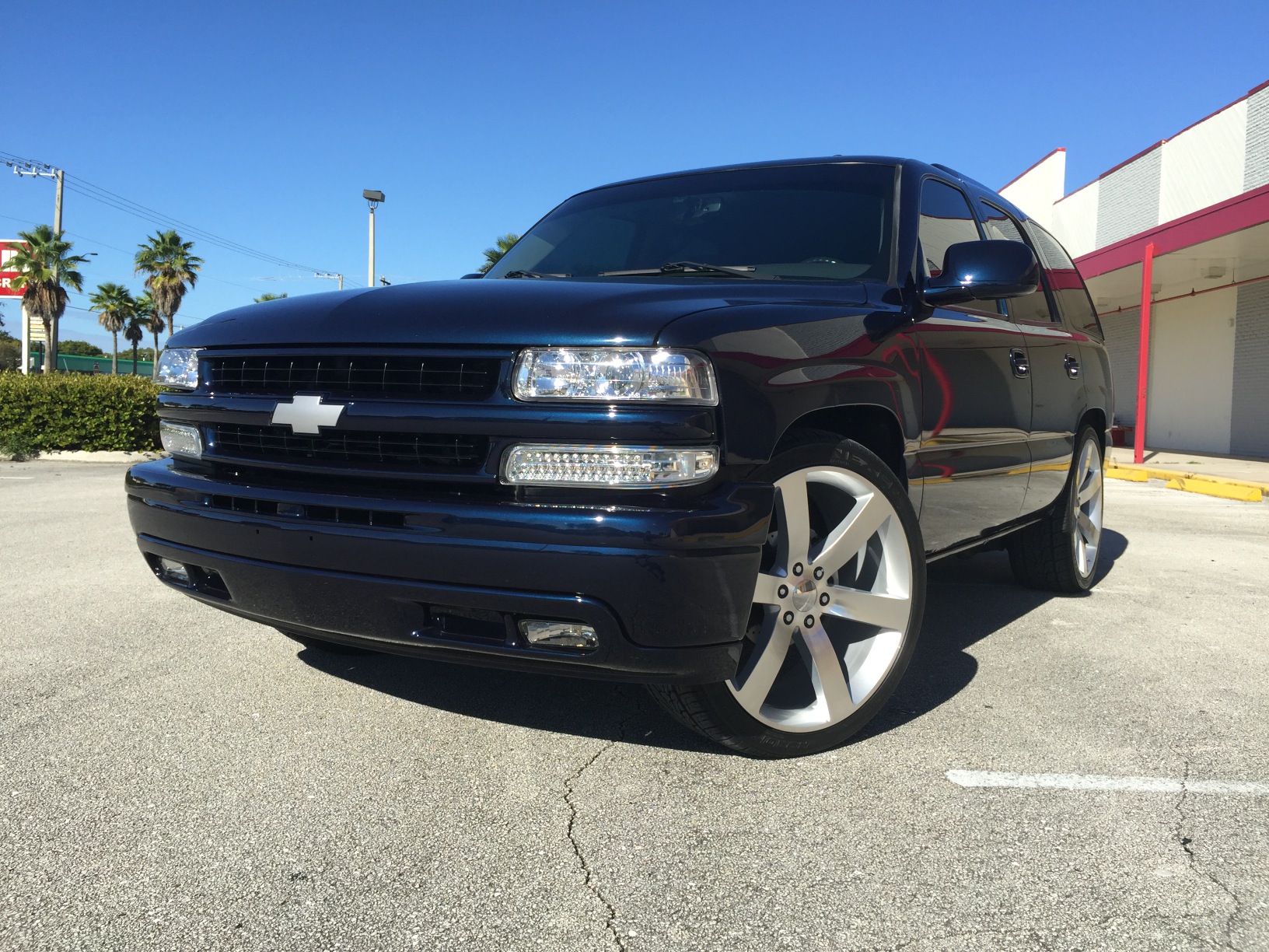

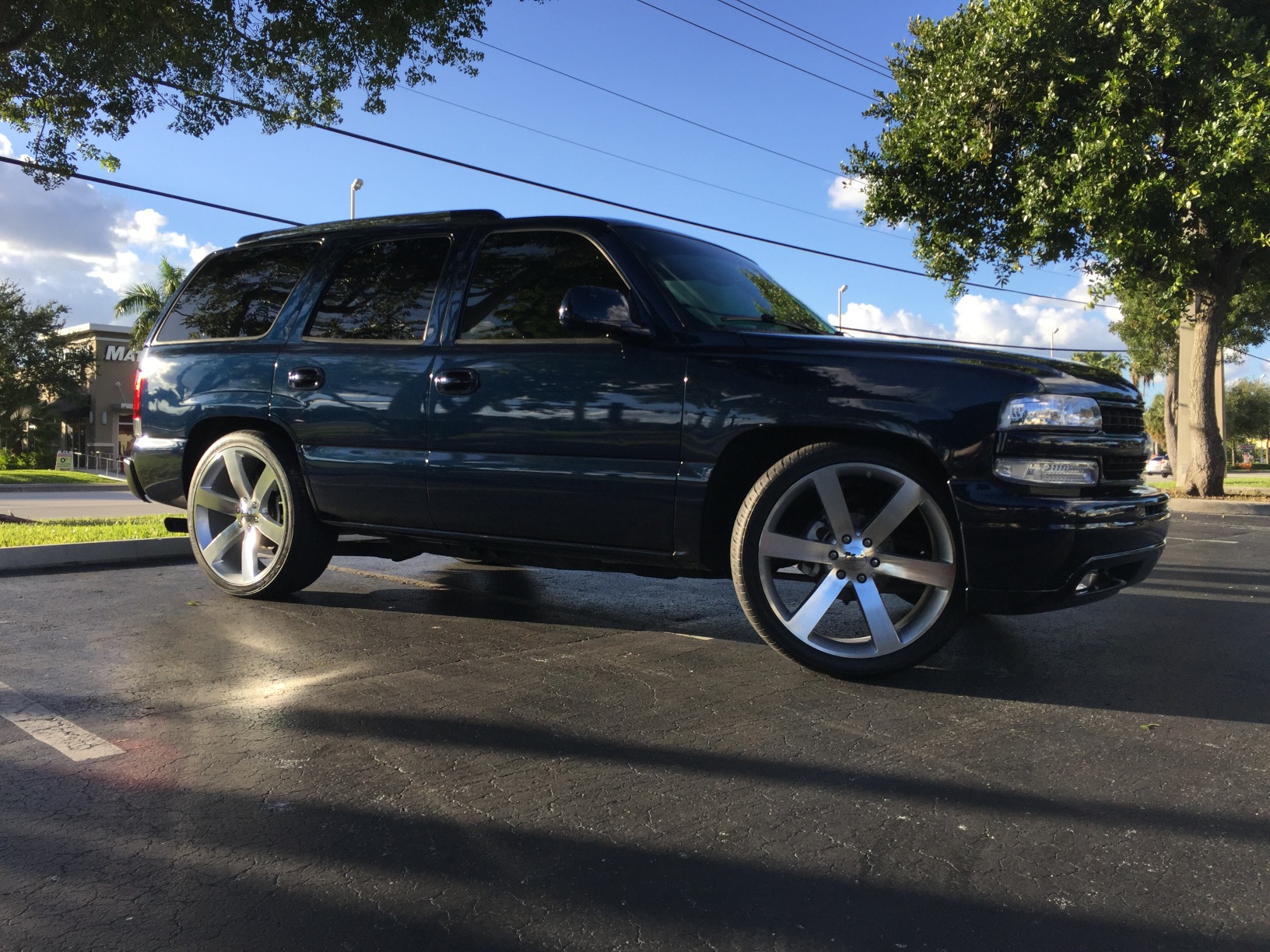

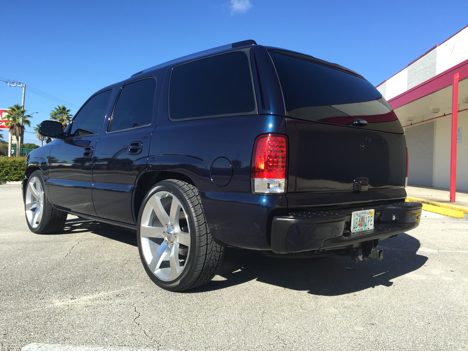

I waited 2 weeks for the color matched parts to come back from the painters. And it was worth the wait as they look sweet!! During that wait, I parked my truck and did a few other small projects. Thankfully my company rental was a 2015 Tahoe LTZ. Not too bad. Like a kid at Christmas, it still feels good to jump in my NBS! The wife just rolls her eyes...
1. I replaced the rear dented bumper with an OEM junkyard one I pulled off a 2002 Suburban a few months ago. I had already replaced the front dented bumper from that same junkyard run when I color matched the top bumper cap.
2. I painted the rear bumper pads, spare tire cover plate and lift gate hatch handle with gloss black Krylon and clear coated them for a good shine. They look new again.
3. While pulling the rear bumper off, I noticed that the license plate light housings were about to fall apart and the plastic lenses were no longer clear, so I replaced those with a quick order from eBay. Brand new shipped for $14.
4. The front passenger Esky roof rack cap blew off just before I parked the truck for the painted parts wait. Turns out the metal ring that is actually attached to the inside of the Esky cap and makes a positive seat on the base post, had come off the cap and seated itself on the base post, thus not allowing the cap to sit secure and snug when I clipped it in. Probably had been taken off too many times over the years since it was first installed OEM. I searched eBay, but could not find that particular side. Finally after a more detailed search, I came across newgmparts.com. I called them up and had a brand new, paint-to-match Esky roof rack cap in my hands a few days later. $42.31 shipped. I had some left over OEM paint and clear coat from automotivetouchup.com and a few coats later, it was installed.
5. I took my dash bezel off and hit it with black Plasti Dip to see how it looked to get a more mononchromatic look as the charcoal/black/light grey color combination of the dash was kind of bothering me. So far it looks good.
6. I repainted my door speaker grills gloss black Krylon.
7. I decided to make a change to my wheels just to see how it would look. I went to the Dip Your Car store out in Coral Springs and picked up a couple cans of Anthracite and Glossifier. I did the deck of cards trick to protect the tires, put some newspaper behind the wheels to protect the brakes and after 4 coats of color and 3 coats of Glossifier I changed the look of the wheels. Gave them some color and gloss for less than $50. Still growing on me, but kind of like it for now. May not be everyone's choice, but I wanted something different just to see. If I want to change it, I can just peel it back off.
8. I hit the front grill bow tie in the same Anthracite color to offset the color matched grill. It was black before and I thought it might have gotten lost in the dark blue. Might go with more of a silver rather than the grey up front after looking it more in the pictures. :boti:
9. Color matched parts.
-All 4 door handles.
-Lift gate handle.
-Lift gate applique'.
-Front grill.
-Both side mirrors.
-Lift gate push button ring. (I did this myself on the truck.)
The painters did not disappoint with the final results. I supplied the paint, they took care of everything else.
10. Installed all the parts this weekend, while watching the kids play out front, gave her a good wash and hit her with another coat of wax for good measure. Went for a blast down the road and took some pictures to share. I've got a few other things in the works, but need some more time.
What do you guys think?
