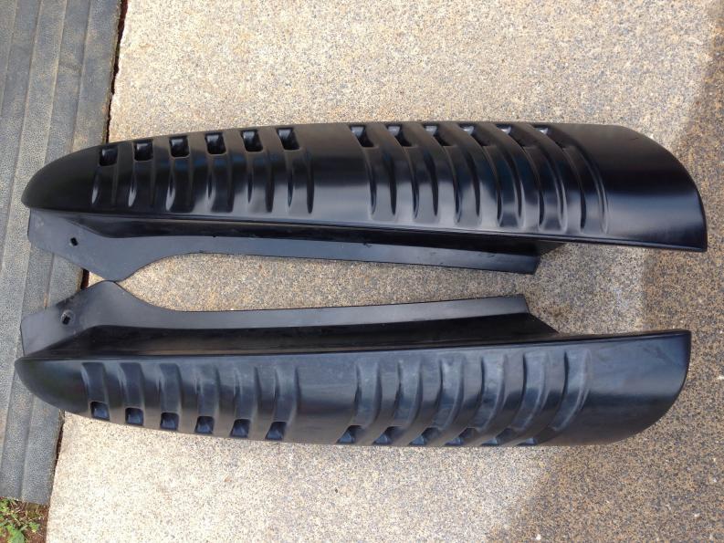

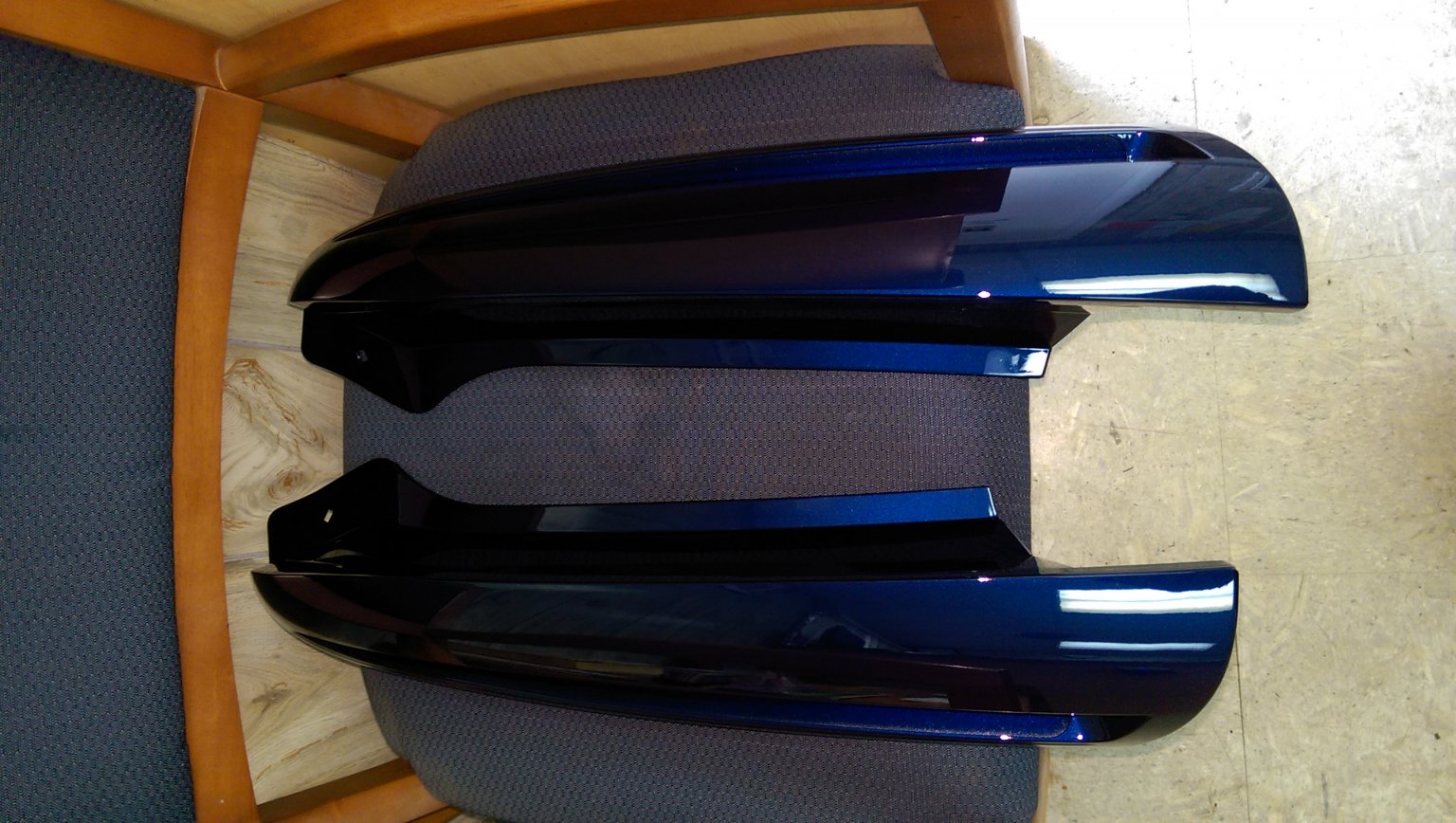

well Saturday finally tackled the job of making my appliques look better on my Tahoe. I looked around on the internet and the cheapest I could find brand new ones was about $180.00 with shipping. I thought that was a lil high so I went to Carquest and bought a $9.00 can of Dupont exterior satin black paint and thought I would try myself. I have to say they came out AWESOME and probably look just like they would if I bought them brand new. The paint did not give it a glossy look but gave it more a look that matches the rest of the trim on the Tahoe like around the side mirrors and bumper. The paint did not run and I just put 2 coats on each applique before putting them back on. Now getting them off was pretty tough, the left one took about an hour and the right one took about 10 mins. I had to hit the applique on the side while my friend pulled a the top part which was loose (pain in the butt). Here are some pics of before and after, hard to tell from the pics but honestly they look BRAND NEW and 10x better than before so im happy. Also I just took the Tahoe through a high pressure carwash and the paint did not chip or anything so I think it will hold up good. I only used a small portion of the paint so I have a lot extra just in case I need to touch up down the road. Let me know if you have any questions.

im glad this worked for you, i have a paint place that is taking my gas door to colour match and im going to spray mine. did you use a plastic prep or anything or sand a bit so the paint would take?
