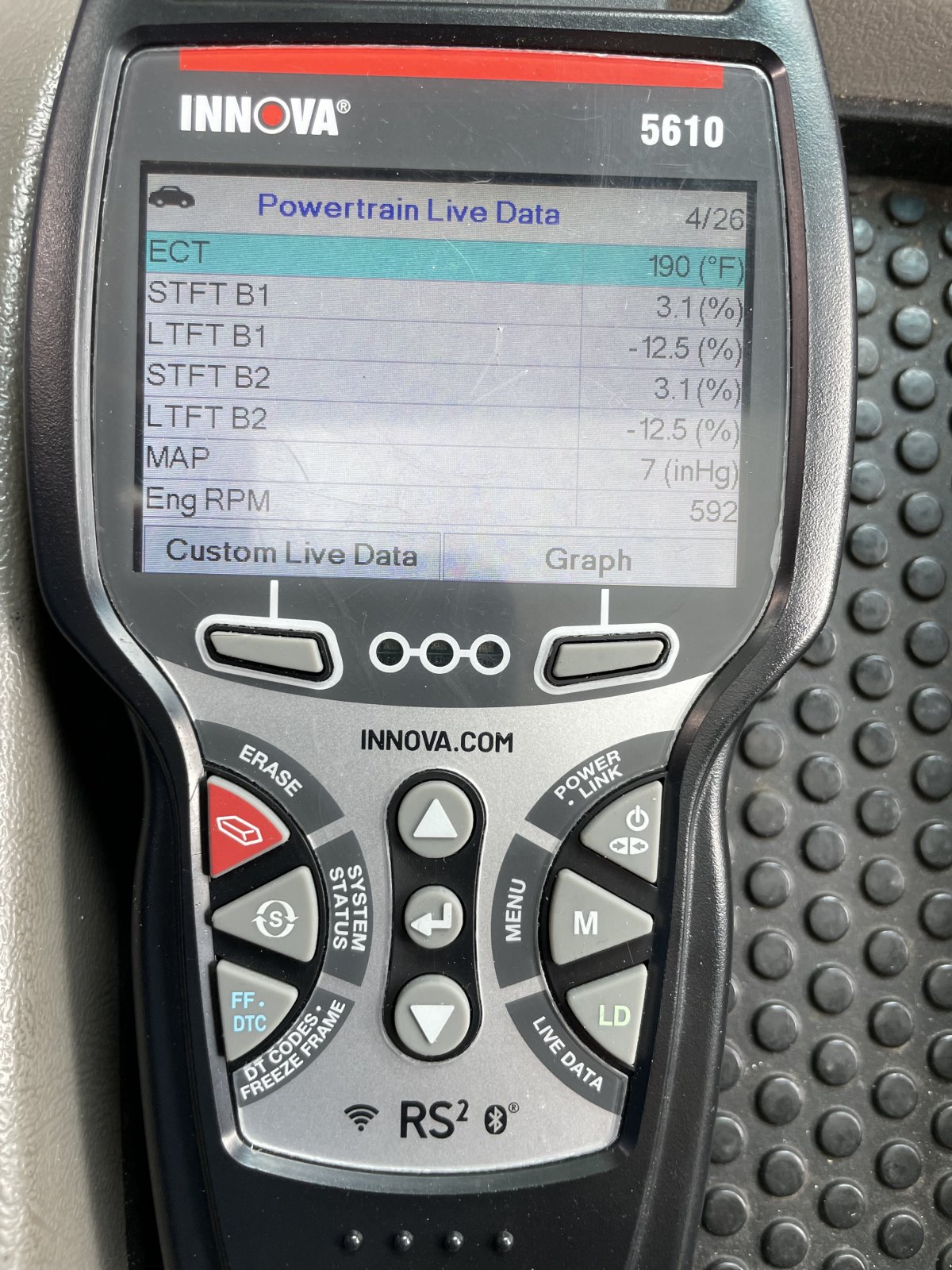

I’ve checked the intake air temp sensor and it’s correct according to my scanner. Example 50 degrees out and iat is reading 76 idling.
Negative fuel trims means you have a restriction, negative means deducting fuel ... a clogged up fender intake with leaves?Disconnected battery for an hour and now get these values.
Idle
2k rpm
3k rpm
These are all done at operating temp and in park. I’ve noticed engine vibration and feels rough at 2k rpm but smooth at all other rpm, idle. Maybe it’s the clutch fan making vibration at 2k? 1.8k rpm is smooth.
I actually tested this by putting a piece of tape over the screen for the MAF sensor the fuel trims went negative -12-15 from positive 15-18.
