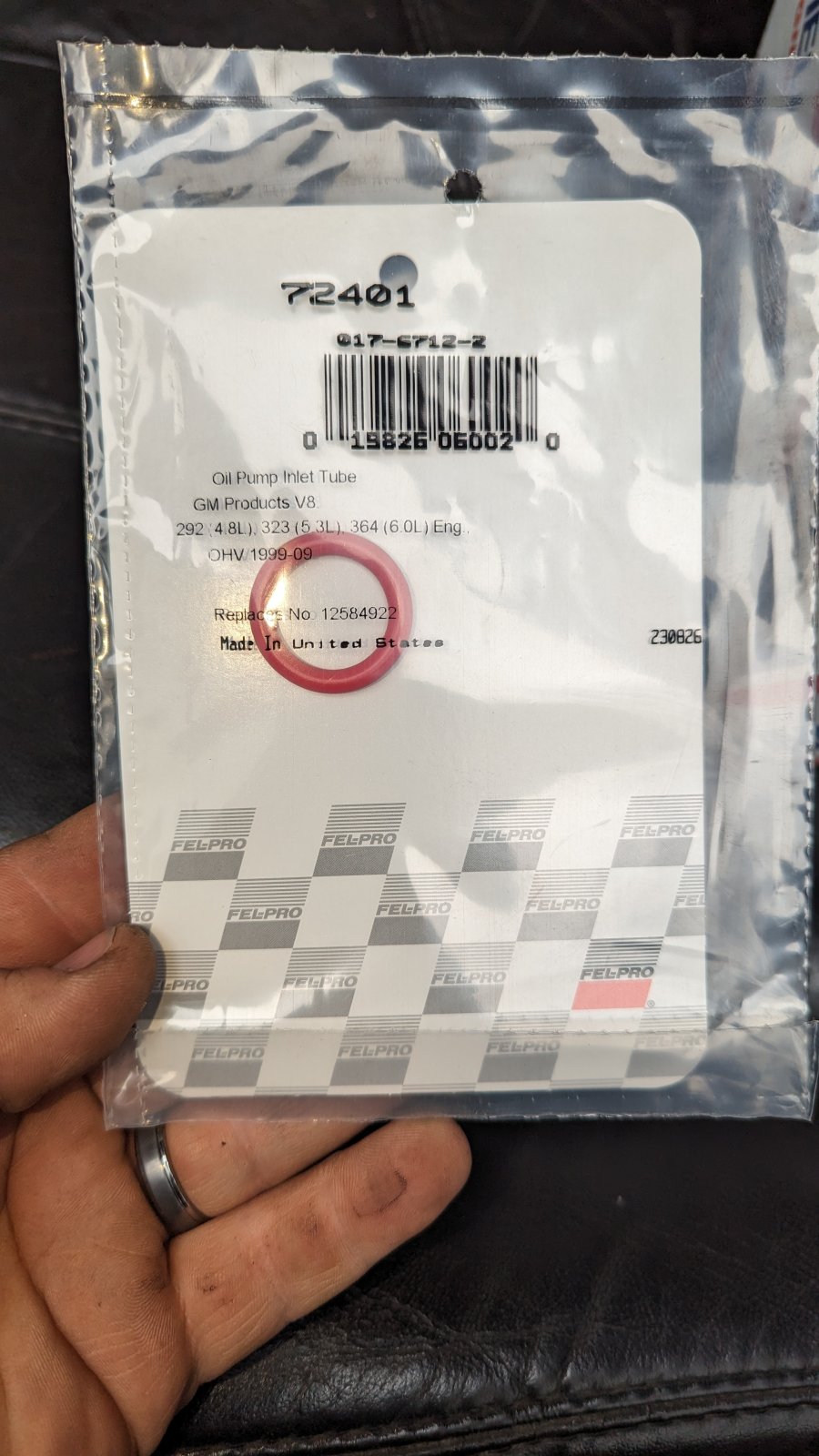

On my 07 6.2 I installed Felpro 72401 5+ yrs and 65k miles ago as preventative mx.
