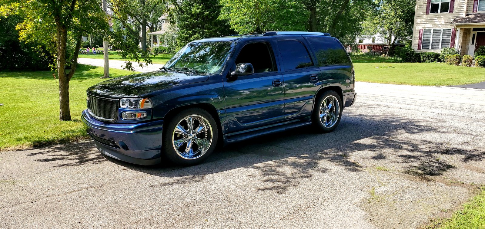

You can go low on a budget, too, with something like a kit from Crown.
