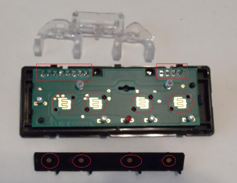

When you turn the key to the on position, do all of the 4wd mode switch lights cycle through the different modes? They should. The switches can be an issue, but you can pull yours and ohm it out, clean the contacts, and reflow the solder joints if you're relatively handy. If you don't find the thread that applies to the switch test with an ohm meter, post up again and we'll find it for you.

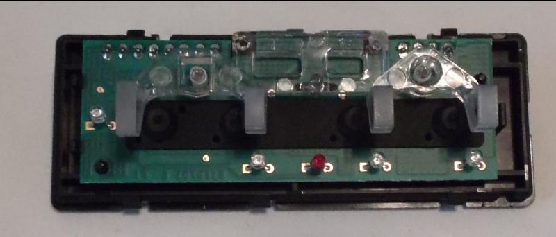

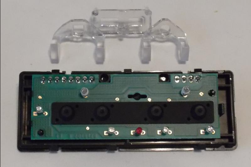

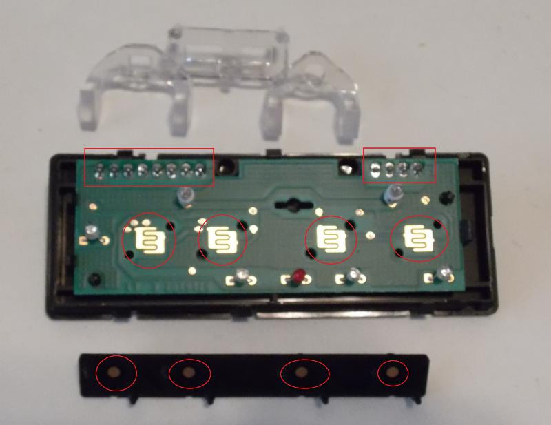

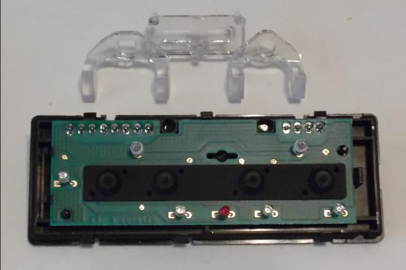

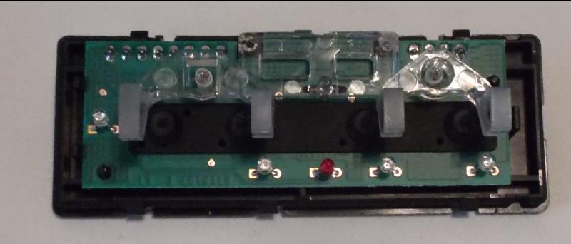

An easy thing to try if you can solder. Pull the dash switch and separate the case. Check and re-flow the solder for the four or five large terminal tabs. if you look closely several might be cracked. I had photos of this and found a thread on it a year ago but I cant seem to find it again.
