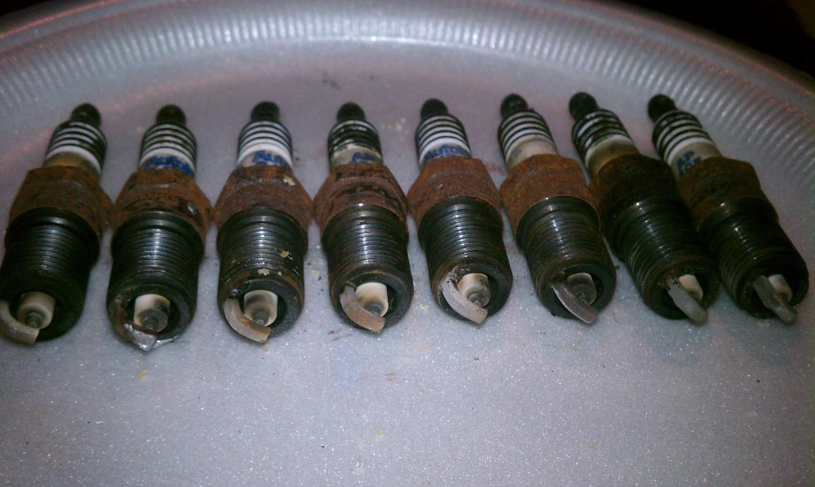

[/COLOR]just put #1 on a piece of paper nearby so you don't have to take time editing the photo with labels.
No need to label them anyway, they are not arranged anymore... they were so similar I didnt bother keeping them matched.

Daaaaammmnn! acdelco 41-993's LIKE NOW! One of them looks to have physical damage is that something you did? Also if you have the stock ignition system the spark will be a little weak unless platinum is on both electrode.
---------- Post added at 11:25 PM ---------- Previous post was at 11:20 PM ----------
Almost looks like they were the wrong heat range as well.

I put the correct plugs and wires in today, no difference.
---------- Post added at 02:43 AM ---------- Previous post was at 02:42 AM ----------
One of them has anti sieze on it

The interesting thing is the truck was always suggesting cylinder 6 misfire, but by looking at the plugs you can clearly see its an "all cylinders" misfiring issue. Its weird because it doesnt feel like a lean misfire to me, I run my race car on E85 and sometimes I have to tweak the fuel columns to adapt for changes in the Ethanol Blend, I have gone from pump gas to E85 without any Air/Fuel Tuning and the car was obviously running stupid lean and it didnt feel like this. Also if the truck was running lean why is my fuel economy so poor? lol
