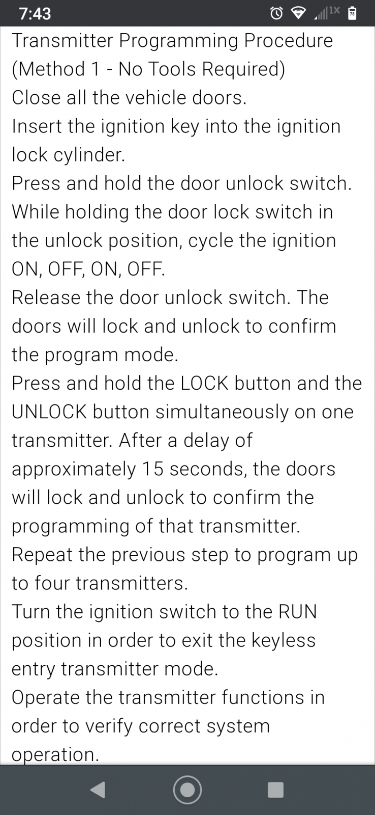

The original remote did work already so I’m sure it wasn’t the battery. But to be positive I did swap it with a brand new one. Still nothing on either fob
Almost forgot: Welcome to the forum from Oregon
In answer to your concern. You may have a problem with the BCM or the circuits with that. Check ALL fuses and while I would say make sure the fobs batteries are in good shape, I would assume it is not that since neither will program but I do hate to assume. I get that the steps I supplied are the same but I did not know that and that is why I supplied them. I also checked at the web site and the steps for a 2001 and a 2005, my rig, are the same.

Again, thank you very much. I will check fuse 60 but I have to assume it’s fine being as literally everything else in the truck works fine. Hopefully someone has the answer!

The thing is, if the old fob worked and then would not after the program attempt, I don't know that the BCM or a fuse would allow the original to work one minute and then not work the next.

I agree but from what I understand entering program mode in the truck erases or resets its fob memory which is why whenever you program one, you must program all others. This is why I wish there was a way to rule out whether it’s the bcm or not. At least if it wasn’t entering programming or other things weren’t working correctly I could assume it was the bcm at this point. I just don’t want to drop $200 and still have the same issue.
