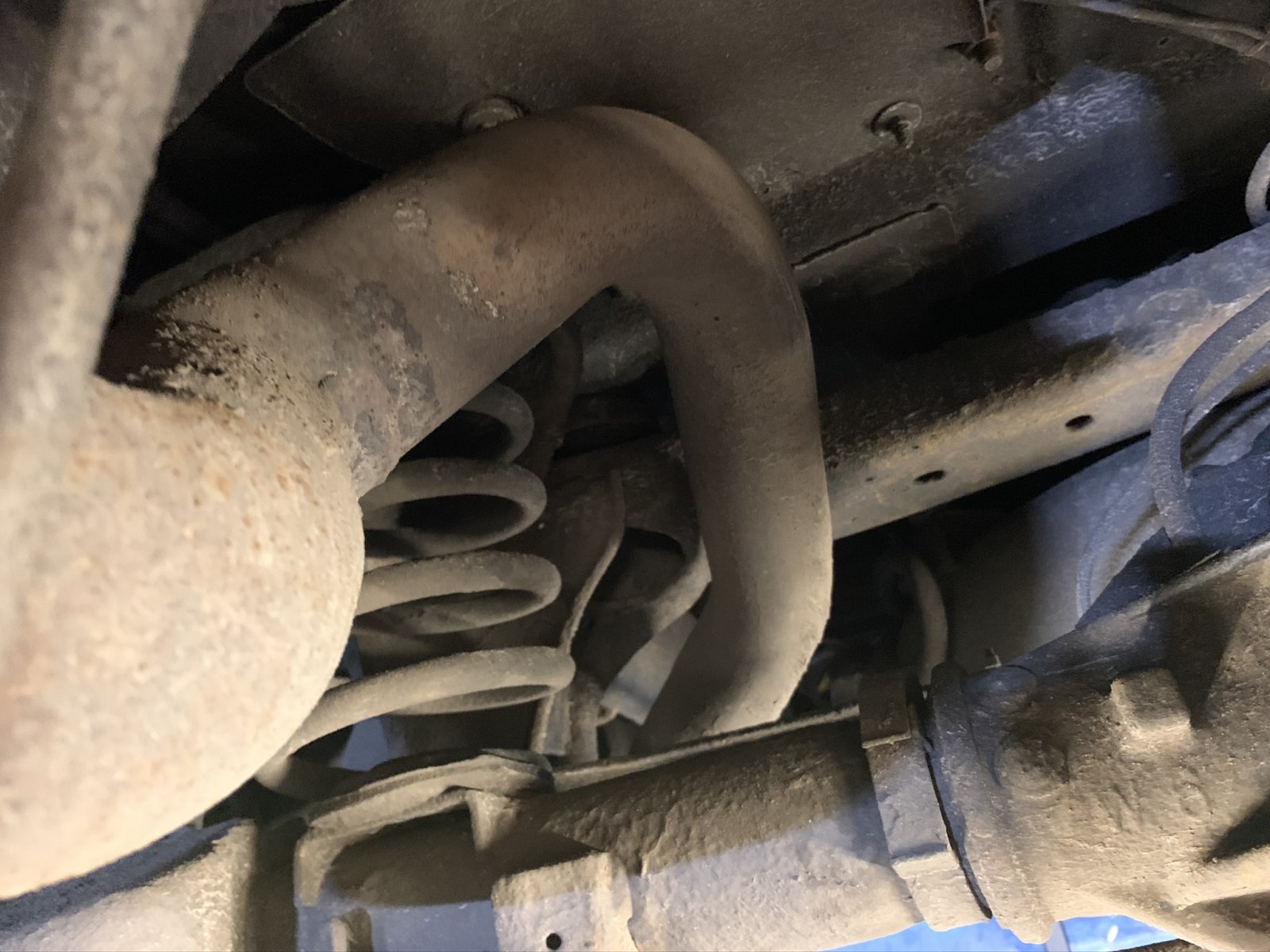

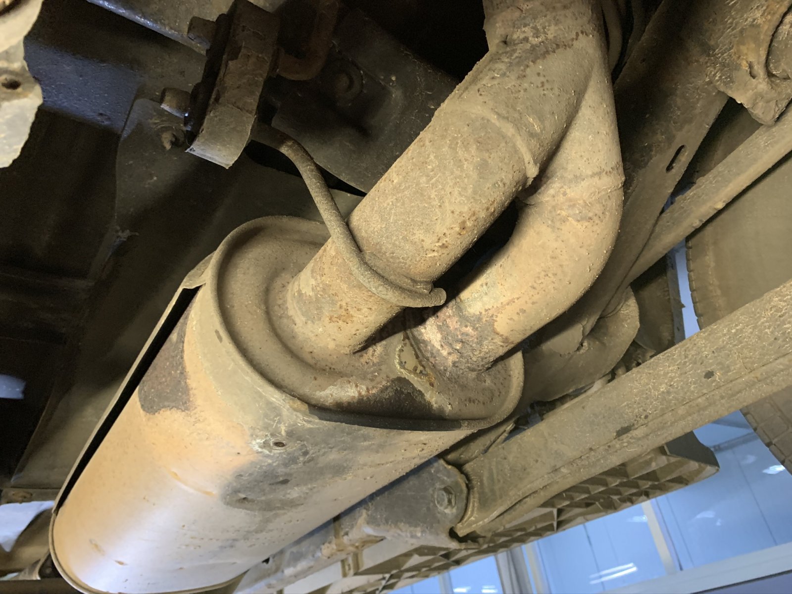

Now my following question. Because I've a muffler bigger than a truck, you can barely hear the beautiful v8. In some cases it's actually handy but I really want better sound, and if possible with my budget, a exhaust that can give some extra power and torque in combination with the tune incoming. My exhaust:

Exhaust: options in the Netherlands are a lot less then you guys have in America. But I can get for example a flowmaster 40 series muffler for €155, 3 inch in and out. Also possible to get Magnaflow mufflers in Holland or Germany for example. I first wanted to straight pipe it, but it will probably be to loud.
So what do you guys reckon? Waiting for your opinions.

This is what you'll get and it'll be quiet as stock when cruising. It's a beautiful thing. lol
The muffler isn't really a terrible restriction for most any normal driving. Due to it's design, it does slow the flow a little at WOT and higher RPM, so there's room for improvement. A few horses were sacrificed in the name of quietness. But, you can get a free-flow muffler that operates much like the intake tube- It won't be much louder when idling or normal driving, but will have a strong growl when you put your foot in it. The Magnaflow #12589 is such a muffler. The next step up in aggressiveness is the #11259. I get the clones of these, made by by AP Exhaust in their Xlerator line, since they are half the cost. The clone to the MF 12589 is the XS2589 and the clone to the MF 11259 from is the XS1259. I'm now running both of these mufflers together, in series, since it got so loud after removing the cats.
I know but that is why I want to change it too. Since I want to tune it to go to 5800/5900 rpm shifting point. Unfortunately I can't get these mufflers in Europe you mentioned. https://www.celtemp-services.nl/3in...7_2557.html?osCsid=7po8dfuvd1i48of7feulevkes5 this is my chose for 3 inch in NL for Magnaflow. But is for example this muffler from Flowmaster Flow FX https://www.ajspeedshop.nl/a-574228...lowmaster-flowfx-mufflers-2-25-2-5-en-3-inch/ a good choice? Also freeflow and €85 euro, is $68 dollars. Because the Magnaflows you mentioned I can only get via ebay and will be like $150+ dollars plus including shipping and taxes. Thanks for your proper information so far :)
