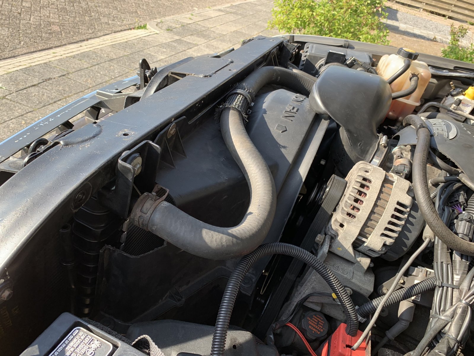

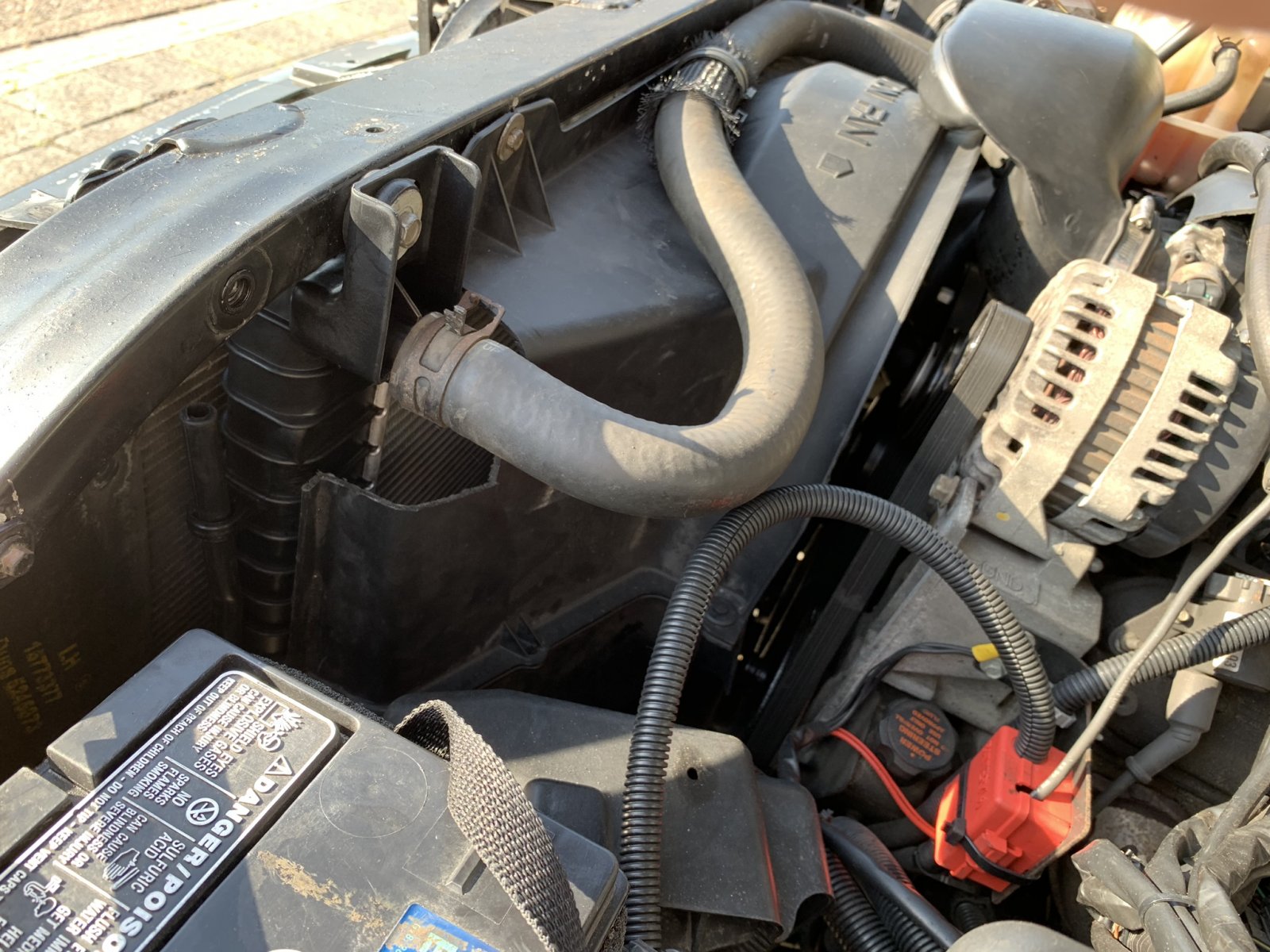

I will check tomorrow. Everything is overkill on my Hoe so hope the alternator as well. Foe example have two ACs stock, one in the front and one in the back that was for the back passengers, or is that OEM on every Hoe? But prolly need a bigger radiator since I installed a smaller one after the stock one died. Wondering though if you just cannot make a bracket to put the fans over the smaller radiator... As is uses the radiator mounts normally, those mounts are still there, the smaller mounts are now used by the radiator.:hmmm2:

The smaller RAD uses mount holes/points of eFans(fan shroud), and may not fit with wide between left and right radiator hoses.
But you can still use efans from Corvette or Camaro if you install 28inch RAD. Or some aftermarket like Flex a Lite etc..

EDIT: I had to modify the shroud, but is installed as stock on the stock mounting points. But you have a point about the hoses them self, who will probably be in the way. Well I guess I will find out some way or another..

Was to lazy to walk to my car, but found a photo of my custom shroud and alternator, what do you think?

Yes this radiator is for sure new and smaller. But ALT should be sufficient(if you dont have crazy stereo).
As for mod, if it work and does not overheat, than OK. I did similiar with heating hose for throttle body :)
