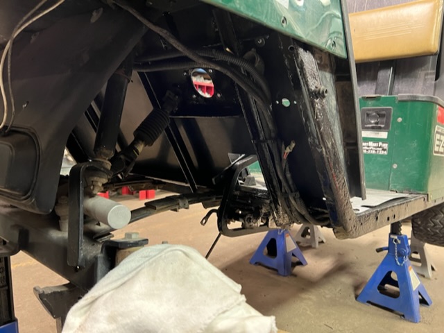

It kept me busy though. Both frame rails were rusted through so I replaced them. Chipped and cleaned all the rust scale off everything, cut it out and replaced it or sealed it with rust convertor then coated it with POR15. I boxed in all the “C” channel on the side rails too for added strength.

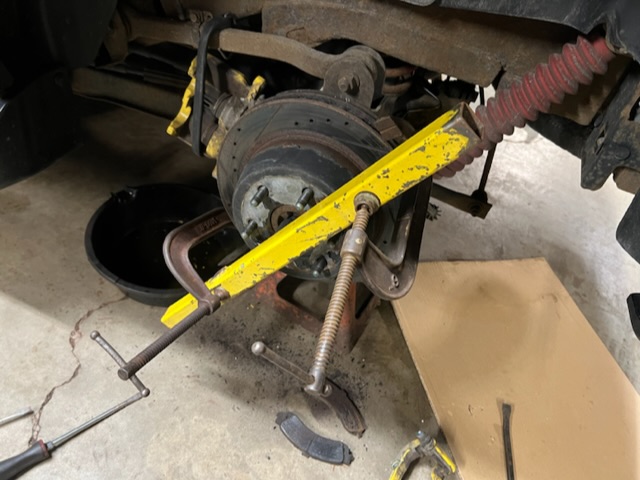

Beginning of April I had to do the rear brakes on the Esky. I thought it wasn’t that long ago I just did them but I guess it was in ‘19. Straight forward brake job until I got to the drivers side and the rotor didn’t wanna come off. The parking brake shoe wore a groove into the inside mating surface and I had to force it off. Beat on it, couldn’t get to the parking brake so I didn’t care if I destroyed that brake shoe. Ended up applying pressure to rotor and had to drill a hole in rotor hub face and use a punch to beat the shoe past the groove.
Hole drilled in rotor face at bottom near outside edge.
Replaced parking brake shoe, hardware and one caliper bracket due to worn out caliper pin hole.
