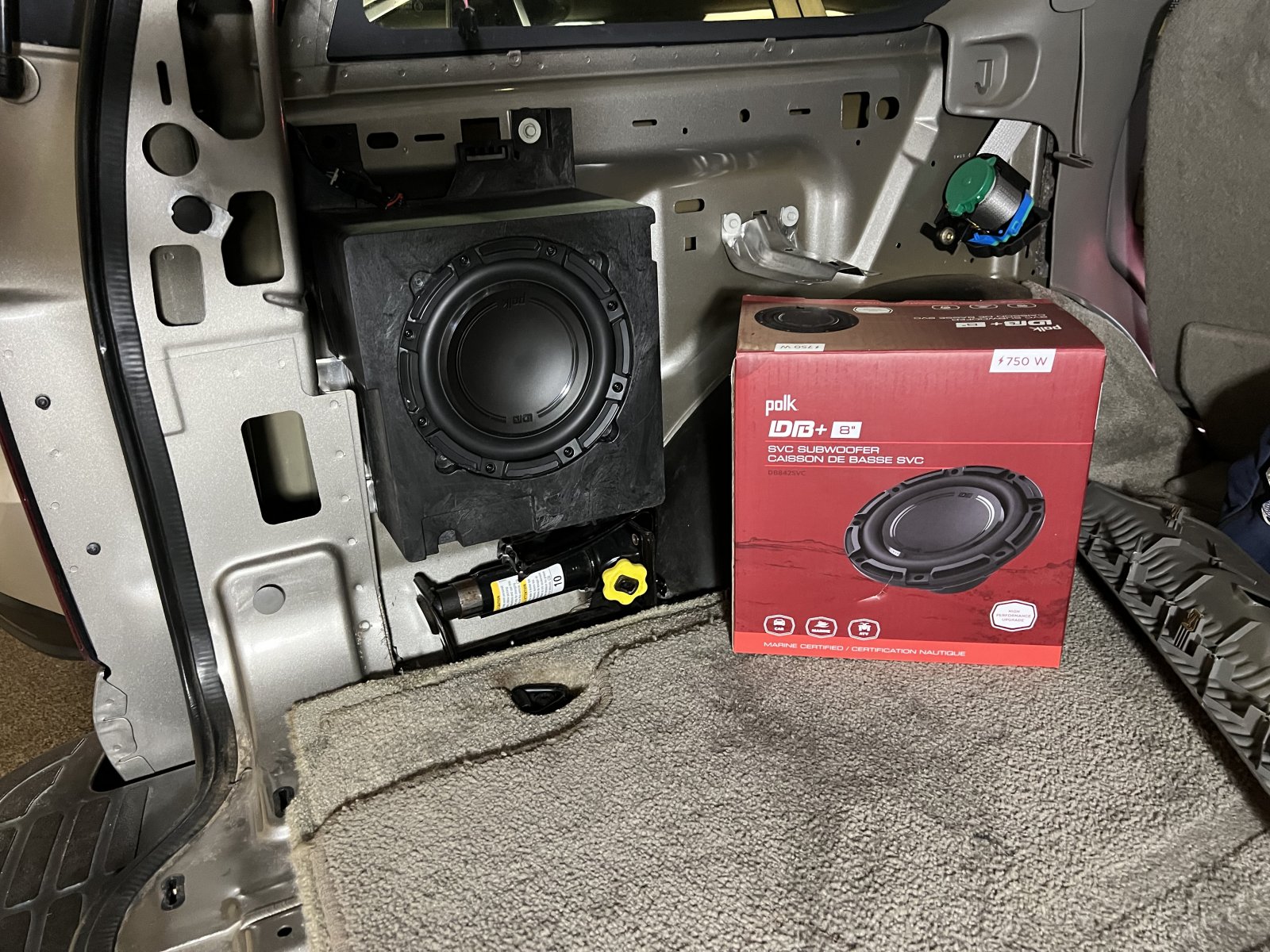

Lots of good suggestions here. You sound like an experienced Tahoe guy, but remember on these there’s a factory amp behind the glovebox. It has a filter that cuts all the bass from the door and pillar speakers. Bass goes to the sub in the left rear enclosure only. Years ago there was a post with a plug wiring diagram to bypass the amp and have the head unit drive the door speakers. I got some replacement speakers from Crutchfield, bypassed the amp, and had a much better sounding setup. Certainly not a premium system, but a lot better than the stock setup.
