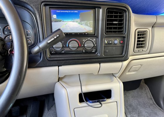

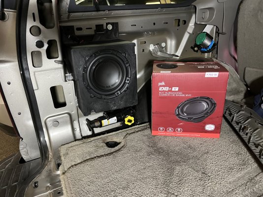

I use a Sony in my 2001. No volume knob. No CD player. But it fits simple and clean in the dreaded “DIN-and-a-half” location without cutting the metal support bracket because it’s shallow dimension. I’m not sure if 2002 is double-DIN or 1.5-DIN.
I used the Crutchfield prewired harness and would highly recommend this.

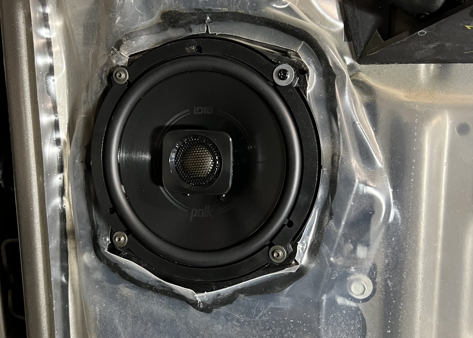

Also, your speakers are probably disintegrated after two decades. I used Polk 6.5” and they were a near perfect drop-in.
Look forward to seeing some pics!

'02 is 1.5 din unfortunately. That's pretty nice that you found one that fits without cutting.
My '05 doesn't have a volume knob and it's kind of annoying, so I will probably stick to one that has the knob.
Yours has a really nice fit though, that's a pretty clean looking install.
I'm guessing my speakers are probably pretty weak, but I haven't messed with them much yet. I'll check it out more tomorrow though.
Does upgrading the sub help much, or is there not much difference unless you also upgrade the amp?
