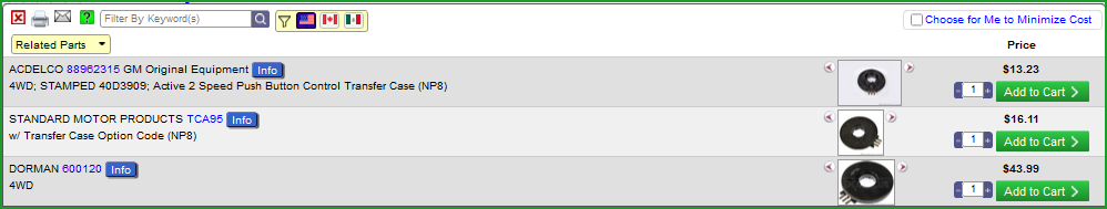

My biggest complaint is this...
The front feels like it's wobbling all over when backing up and when going forward at lower speeds. The wobble is what I have the biggest problem with. The steering wheel has no vibration, smooth as silk. But why the thing wobbles and feels like the tires are skipping the ground while turning is what's really pissing me off
you get anything like this happening?

There's no fault with the abs system. When I got it it did have the typical low speed abs activation where at 10mph you feel it in the brake pedal. But that went away when I did the hubs.
It doesn't feel like it's in 4wd when you're driving. Switch shows 2 Hi. If I push the auto 4wd button and then start to move it hesitates and then Service 4wd comes up. And it won't let me switch back to 2 unless I shut it off and turn it back on. It won't switch into anything else until I do that. If I push the 4hi or 4lo while in 2wd, you can hear it switch and clunk into 4wd. But I haven't needed to use 4wd at all yet.
I know the switches can be faulty a lot. I haven't noticed anything out of the ordinary while under the truck and inspecting the front transfer case or anything. Didn't see any cracks or anything. But usually when you're in 4wd you absolutely feel it while driving. And I don't feel that while driving. I always keep it in 2 hi.
