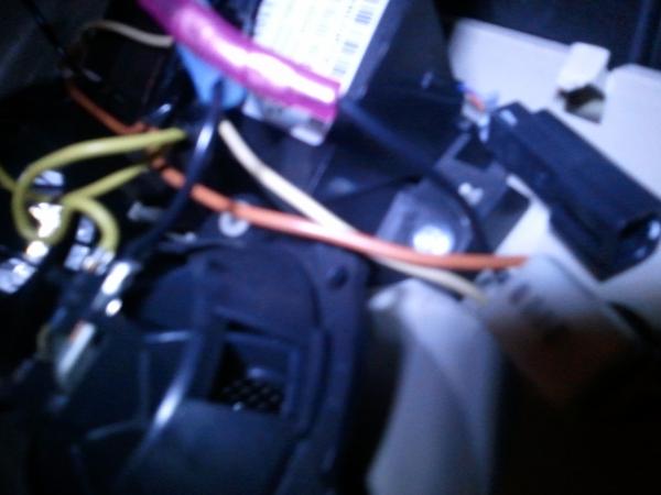

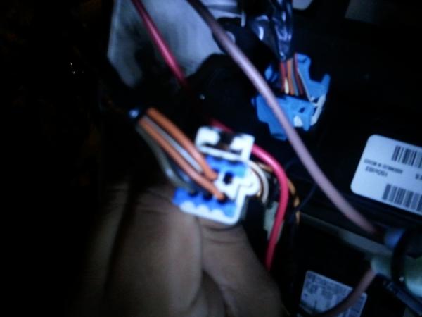

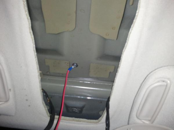

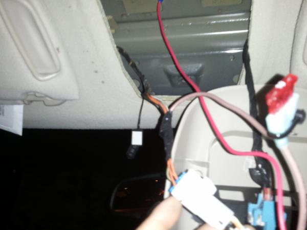

As chauncy said, the pics and all this thread basically are of the " Relay making a annoying buzzing sound, (vid i posted up) as well as the one dome light the relay is on, goes dim for some reason. Then you have to click it to make them all bright again. Happens all the time. I got tired of hearing the buzzing. So took it all out and back to stock again. If you would like to try what Chauncey and Riveieracing are talking about go ahead. For me, im done w/ fixing this. Other things at the moment more important and i fixed it good enough to use. (just open vanity)
