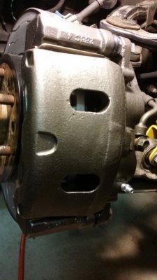

Okay I pulled everything apart again, and tested fitments.
Please see the pictures I added to see if you see anything awry. this is the FRONT DRIVER SIDE
1) the metal retaining clips were rubbing against the rotor (hence the silver circle pattern around the top circumference of the rotor. It appears I need the small wire circle clips on the hub studs to keep the rotor flat. So I will go find those somewhere
2) I am still not getting any caliper piston travel at ALL. I lifted the caliper open and placed a weight on the brake pedal inside the car--pushing it to the floor, and the piston is not moving at all. I turned the car ON, and of course I get the "service brake system" beeping and warning. Is that an air leak (bleed issue? ), or has my master cylinder went kapoot all of a sudden. I had no brake system issues prior to replacing these calipers.
They are new, but could they be damaged somehow? anyway to test them?
Thanks

you installed the calipers with the bleeders facing up correct?
:chair::chair::chair::chair:
just saw that I had the darn things upside down:chair::chair::chair:
so thanks for the help the bleeder is now in the correct orienation, would that be the reason why I have no pedal pressure?
I can't bleed it till my brother comes home arrrgh

Sure would be, air bound and cause most of your troubles. You don't need the e clips to hold the rotor on the lugs will do just fine go in a start pattern while tighten. Also I'd check your hub surfaces make sure there's no rust build up keeping the rotor from sitting flush. Good luck hope it all works for you. This mod is on my to do list.
