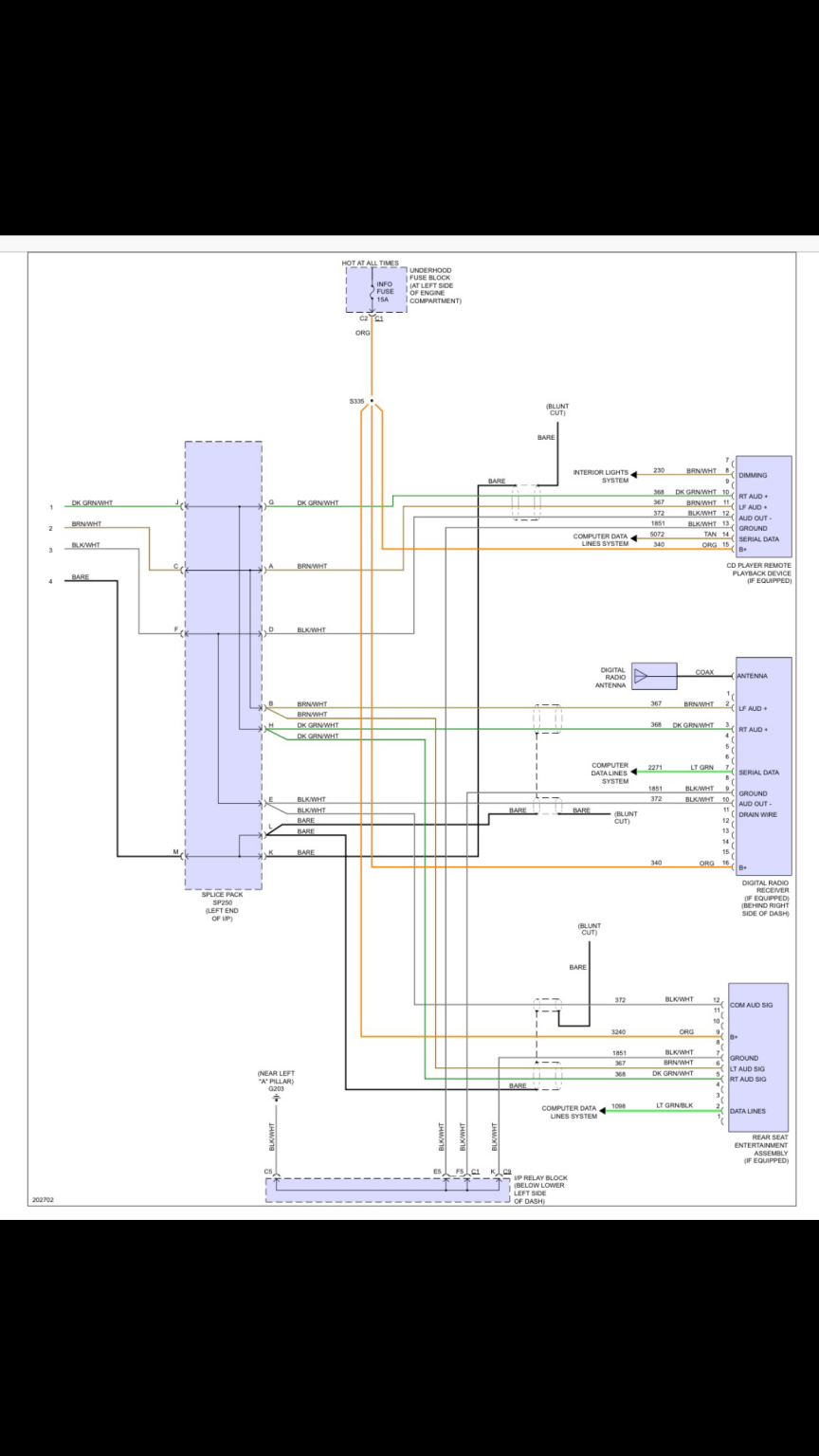

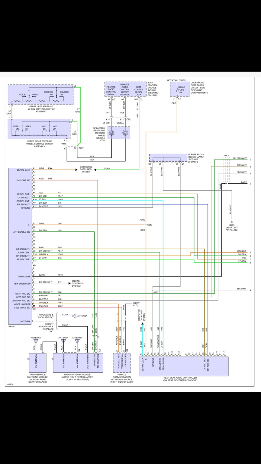

So that schematic is not yours. That's for 'Bose w/ CD' but after looking at your picture and studying all the schematics and different options... your picture matches up to the 'mid line radio w/o rear seat audio'
Here is your correct schematic... the purple wire in your picture was what made me look harder at everything.

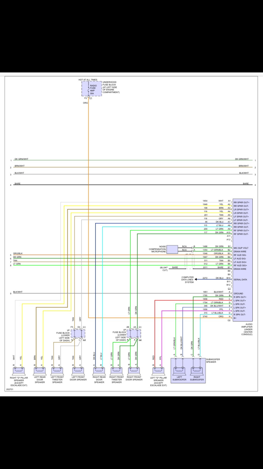

Here's the complete set schematics for your system

I found some wire pins from an old Dell computer that fit into the factory harness. However I connected the 3 wires (H,J and A12) and it didn't work, boo.
M1Gunner, thank you for the updated diagrams. I'll have to study them more. They look pretty similar at a glance, as far as the harnesses that I'm working with go anyways. I feel as though I need to create some sort of return signal to the harness to trick the HU into thinking the XM is there? Unless, if I tap the correct wires the audio signal carries enough to trigger it? Gonna sleep on it. Thanks again everyone.

Looking over these that fit your set-up, a few routes did change so you may want to disregard the A12 ground and use terminal 'K' the "common aud sig" from Connector 2 along with 'H' and 'J'
I tried that last night, but I didn't have pin soldered on so I doubt it had a good connection. Plus balancing the HU, holding the ground and messing with my phone wasn't exactly easy lol. I'll pull the HU out again after work and try again with the ground wire pin.
As a thought, does that 12 pin connector with the 2 voice wires (pink and orange) have to be connected for any reason? We don't use on star so I'm not concerned about that.
