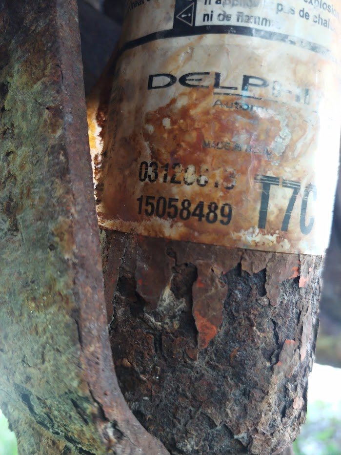

A hundred threads, but most old or airbag related. I have 109,000 miles and the rear shock bodies are pretty rusty, though no sign of leaks. One tire bounces pretty hard at 55mph, so I know somebody's dead...
Is there any source for stock or aftermarket electronic shocks, or am I forced to disable the autoride? I checked rockauto and gmpartsdirect, neither shows them available.

Curiouser.
Shock Warehouse has no database for a 2004 with rear non-air autoride shocks. WTF?
Edit; CK5 forum seemed to know this is standard on the 2500 with possible air ride on top SO.
Looks like not much option but to convert it.
