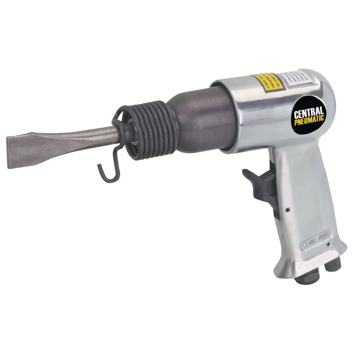

have i ever. its not to bad most of the time. BFH has gotten all of my old hubs off, all but two rears on a regal gs i owned. those two were rusted on there good, had to pound a chisel in there to pop em out. buy a name brand hub too, timken, moog, skf. in the box will be a tag with the tq spec of the axle nut.
