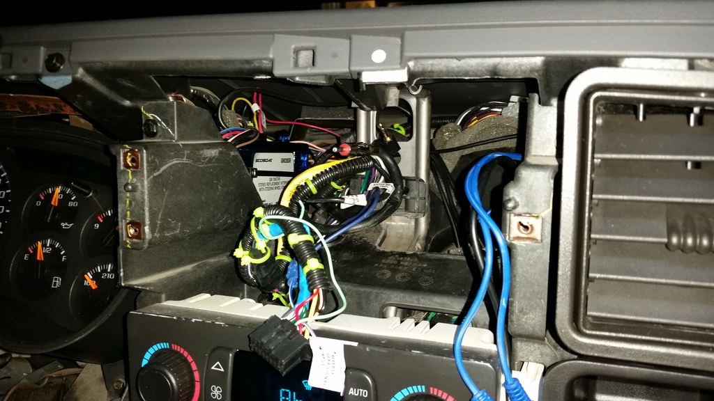

It's a schoche. Maybe it's the module. I'll find out once I get a new deck in there, hopefully this weekend. The thing is it will go for weeks without any issues. Sometimes it''s right after ignition turn over, sometimes it's hours after a road trip. Doesn't matter if on a bumpy road or parked not moving.

Here's the module. Notice the nice place on the left to tuck it away. Looks like a rats nest but I assure you it's not lol. If I put in a new deck and I get the same issues I'll be calling that tech support number on the module
