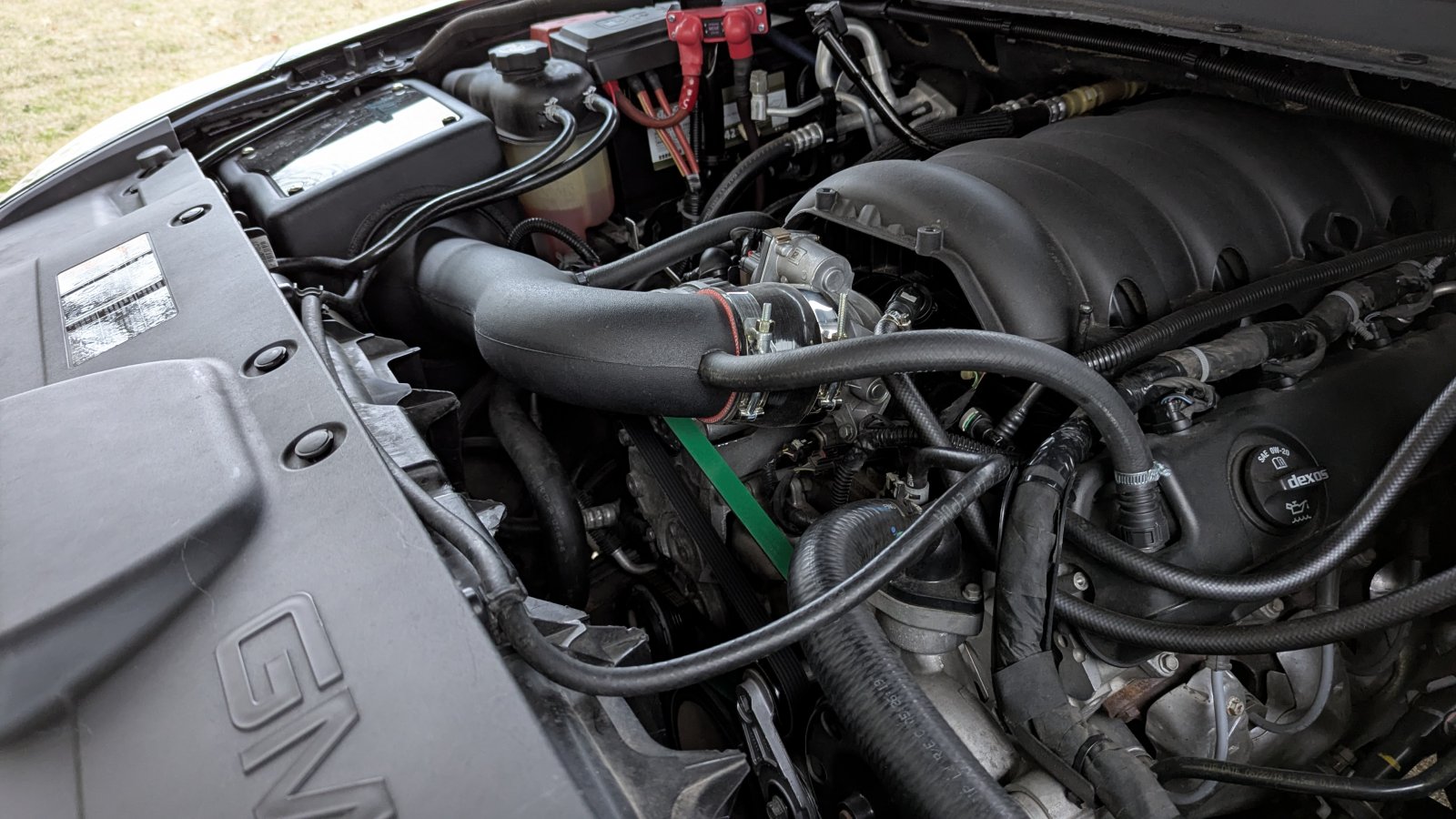

Before reinstalling the intake (after all the coolant spilling was done), my son took over and changed the tensioner and serpentine belt. He looked up the torque specs, set the torque wrench, everything. Yes, he released the tension on the torque wrench after he was done. Anyways, super proud. I did nothing except answer questions:

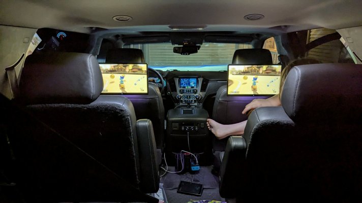

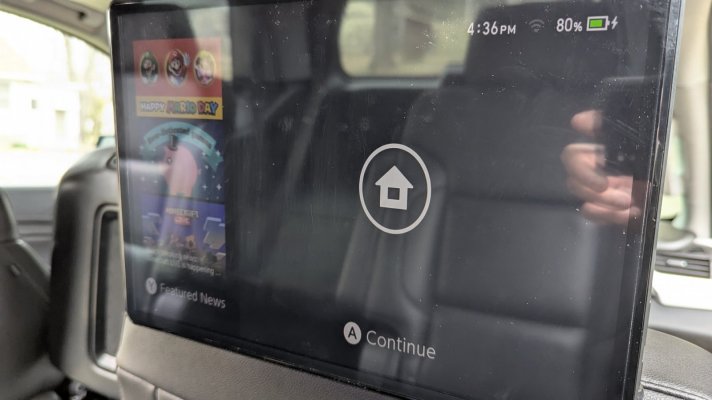

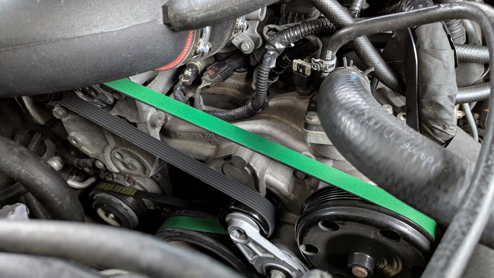

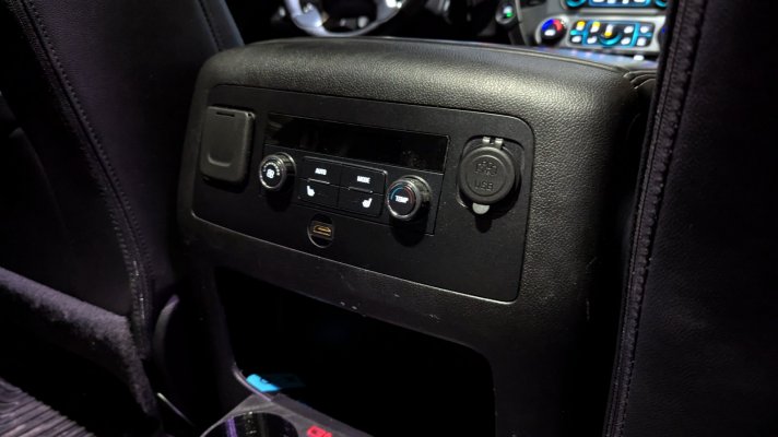

Also, these arrived. Here's a test fit for a functionality test which it seems to have passed. I had to order some 90* HDMI connectors, an HDMI splitter, a 100W PD charger, and a few passthroughs, but the hopes are to have one single USB-C cable charge and provide HDMI to a Switch, ROG Ally, Laptop, ETC. They have the features of tablets on their own, as well:
