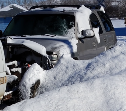

Nice build!ok time for an update, now that the weather is playing nice, i started pulling the old motor.
Quick question, what is the best practice to removing the torque converter bolts? any suggestion would be appreciated.
