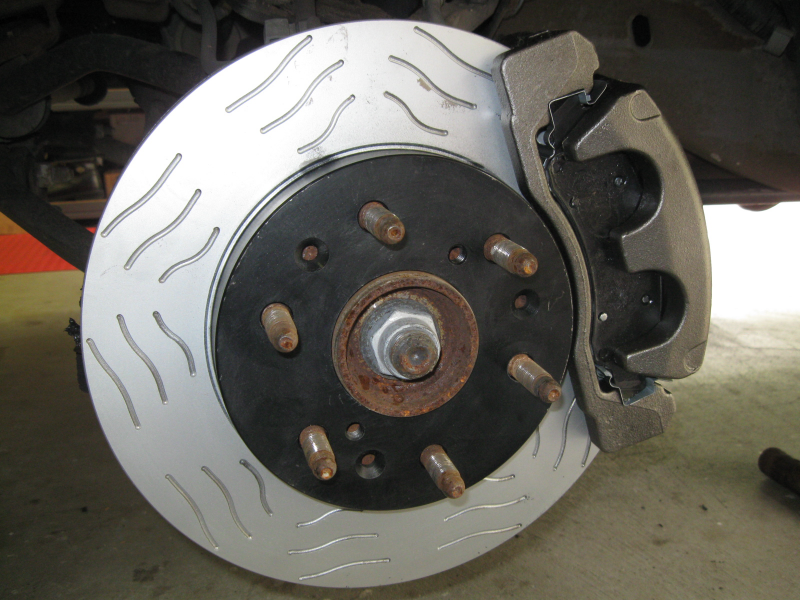

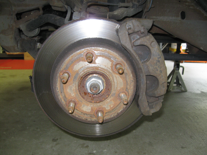

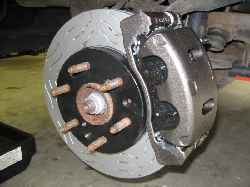

Finally got around to finding time for the Upgrade...........have to say the difference is night and day! Fantastic upgrade! Couple of pics; but due to time constraints, painting the calipers was not an option...... sad.gif
OEM GMT800 setup:
GMT900 update:
Many thanks to everyone that contributed to this post! Highly recommended!!
