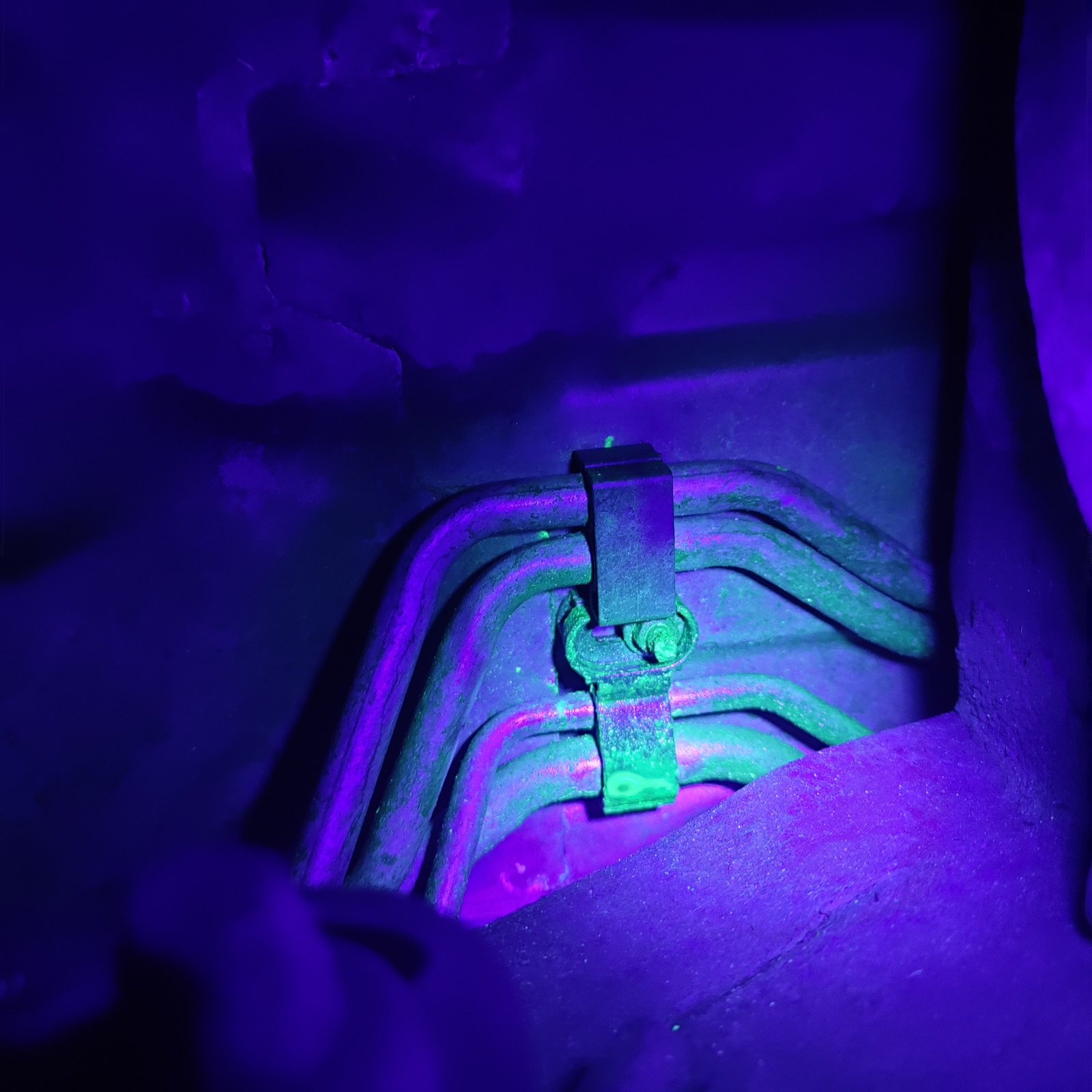

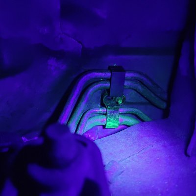

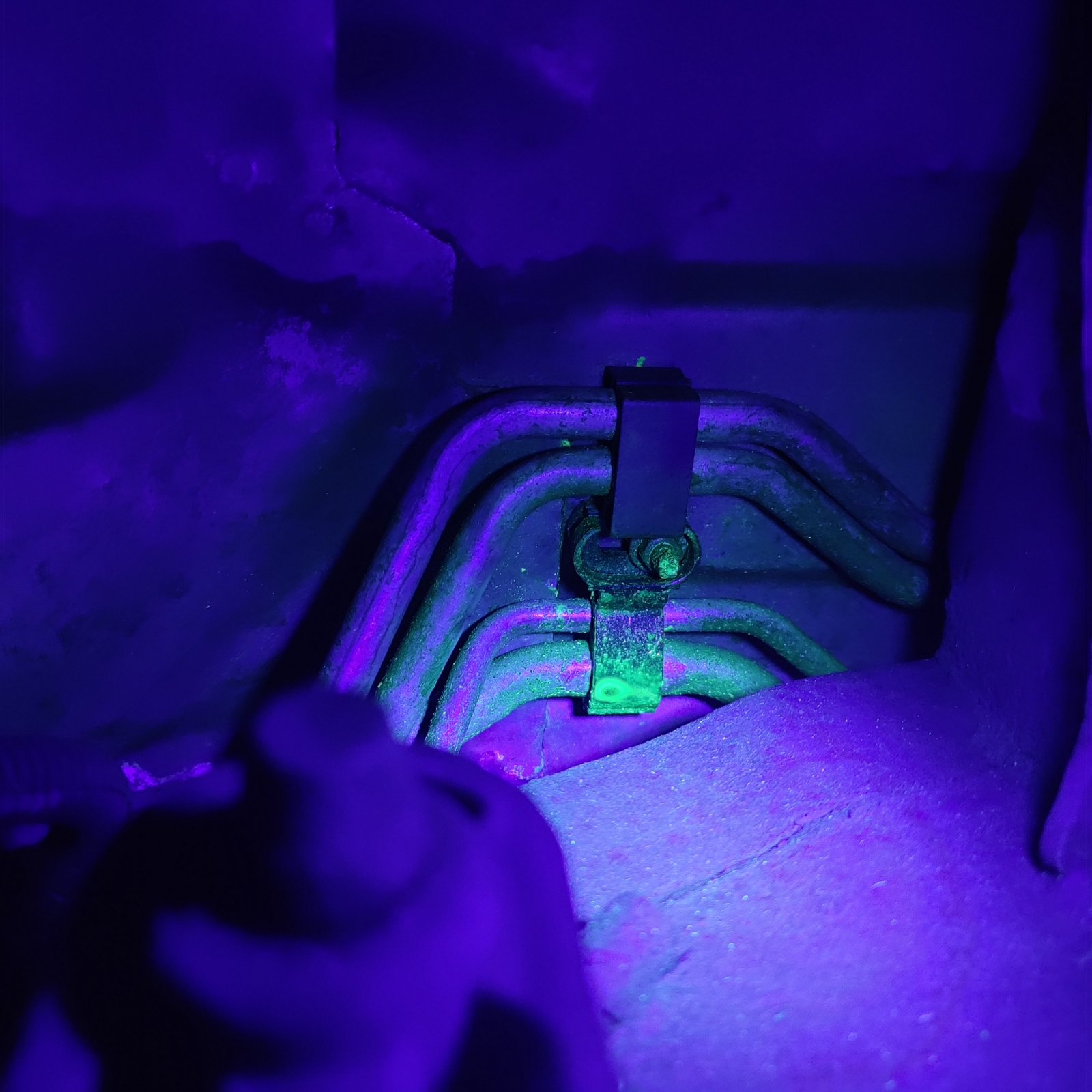

Hi folks,
Ive got a major AC leak on my 07 Denali XL. Luckily with the help of UV we've traced the spot.
Its on the rear lines, roughly above the rear passenger side wheel. Seems to be in the area of the black clip.
Could anybody help me with a part number for what I need to replace here... im on Rockauto, but there seems to be a wide choice of options....
Pictures attached.
Thanks!

The OEM lines are only sold as an assembly with both AC lines and both coolant lines and are cut in half for shipping and still come in a very large box so ground shipping isn't an option. It would be a dealer only item and special fittings and a tool are required to crimp the lines together once installed. Since it looks like you're overseas, even that may not be an option unless GM has stock in Europe somewhere. That rubber line replacement may be your best bet.
