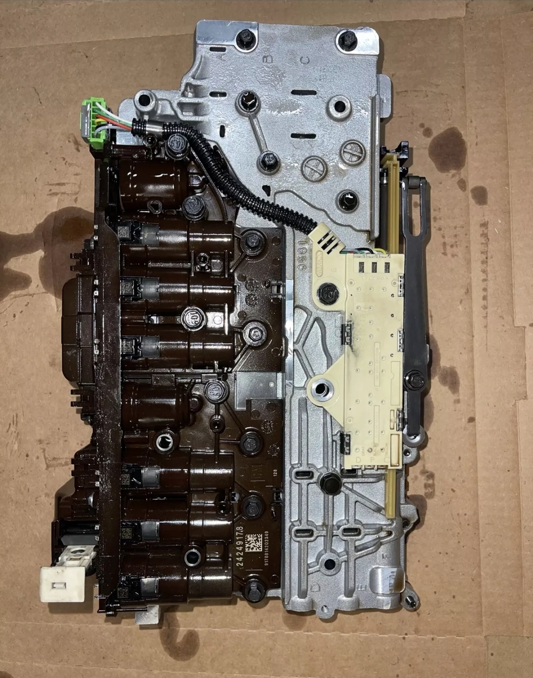

So I just need to take that module that plugs into the green connector from the 07 and install it on the 2012 valve body?

No. You need to use the entire 2012 valve body but you need to use the 2007 speed sensor assembly that is attached to the valve body.

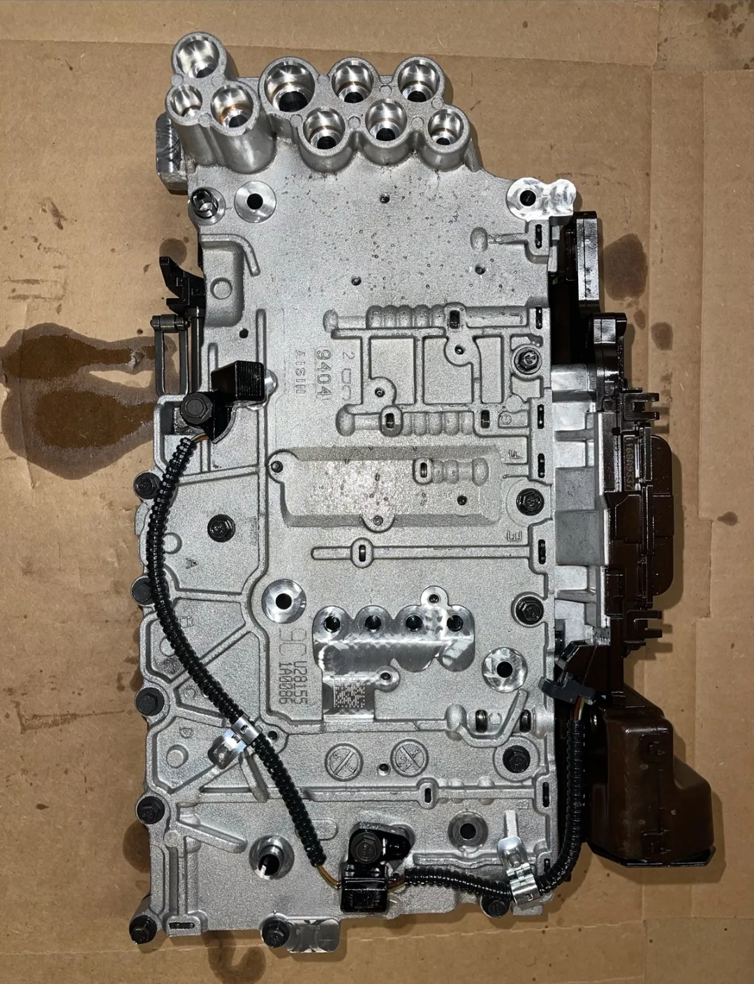

Which is the speed sensor? The off white piece that plugs into the green housing, or the one on the other side?

I’m not sure I remember there being a green housing? Do you have a picture?

Off white thing with green plug housing in the first photo, opposite side of valve body in the 2nd.
