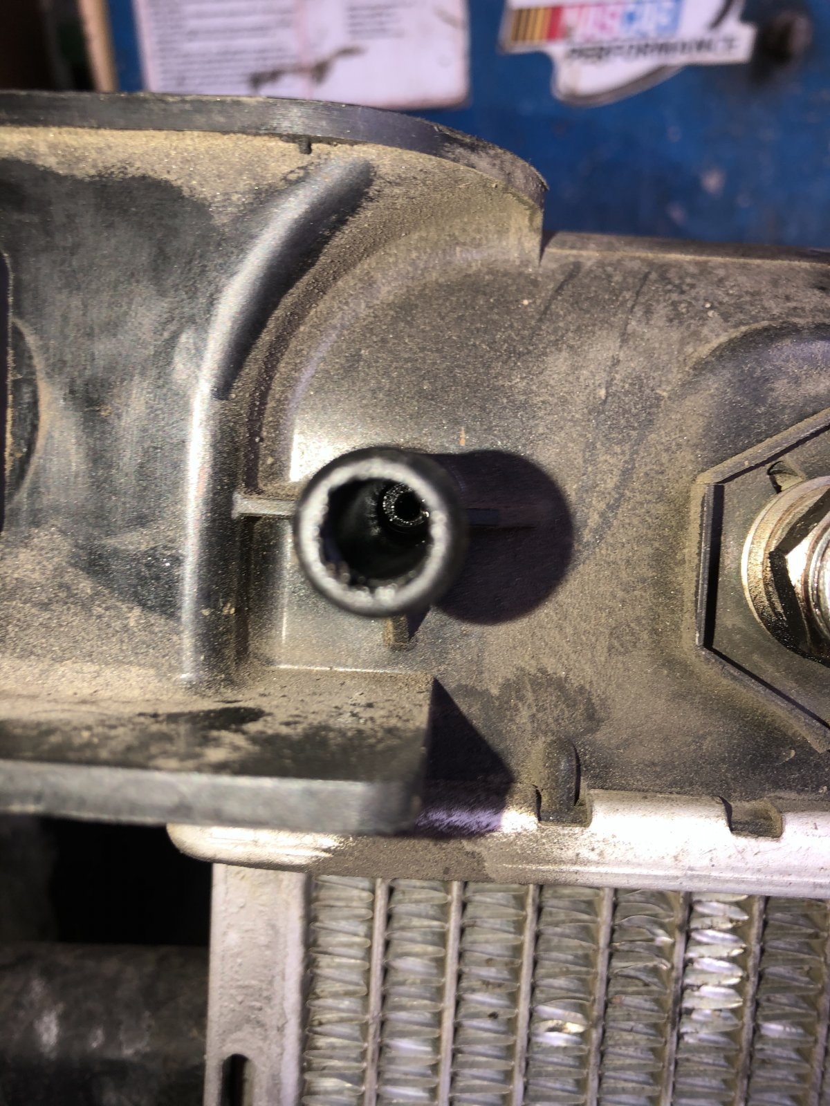

This is correct. I just went through this scenario in replacing the radiator on my 2006 as well. I had read several threads where guys had replaced the radiator and the truck would not get up to operating temperatures. The “engine hot” but is new information. But they couldn’t figure out why the truck was not getting up to operating temp. And as you stated on the OEM radiator there is a small restriction piece in the top line that routes coolant to the surge tank. I was seriously concerned about how to resolve this if my new radiator didn’t have the correct piece installed. I lucked out and the aftermarket radiator I got from 1800radiator.com had the correct restrictor in place.
Edit: hard to see in the photo but that little restriction almost looks like a little washer installed inside the piping that connects to the surge tank line:
