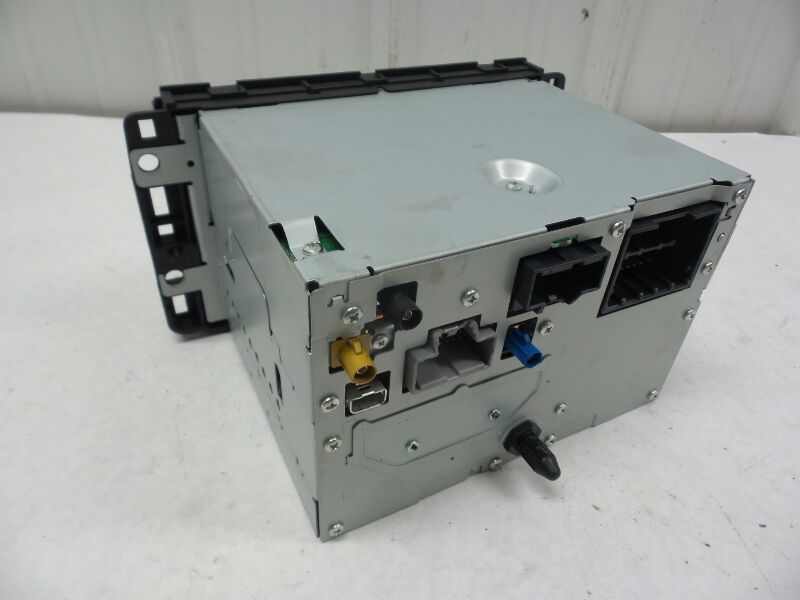

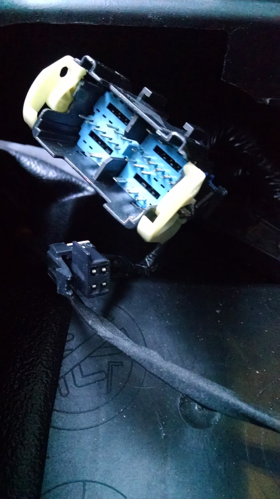

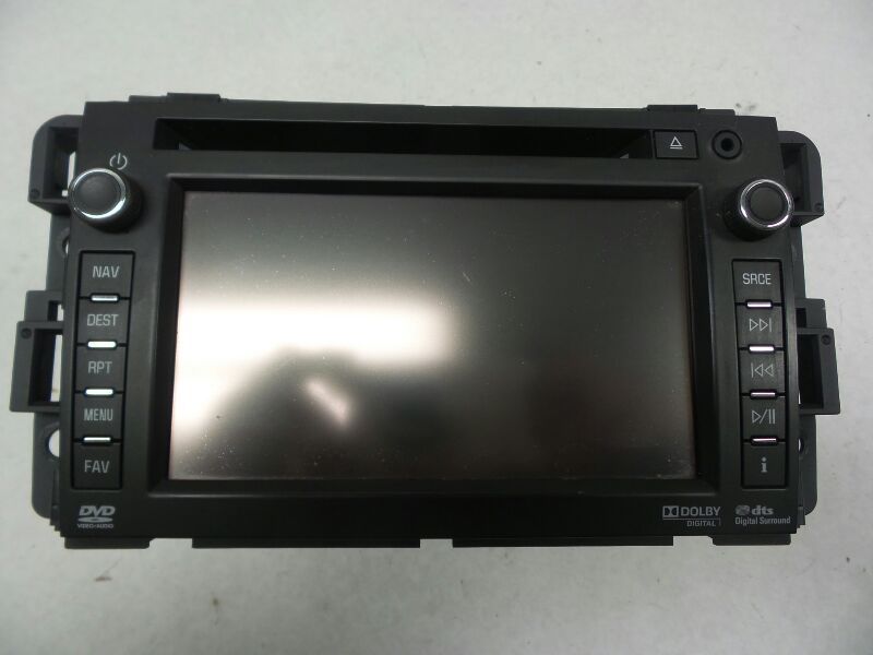

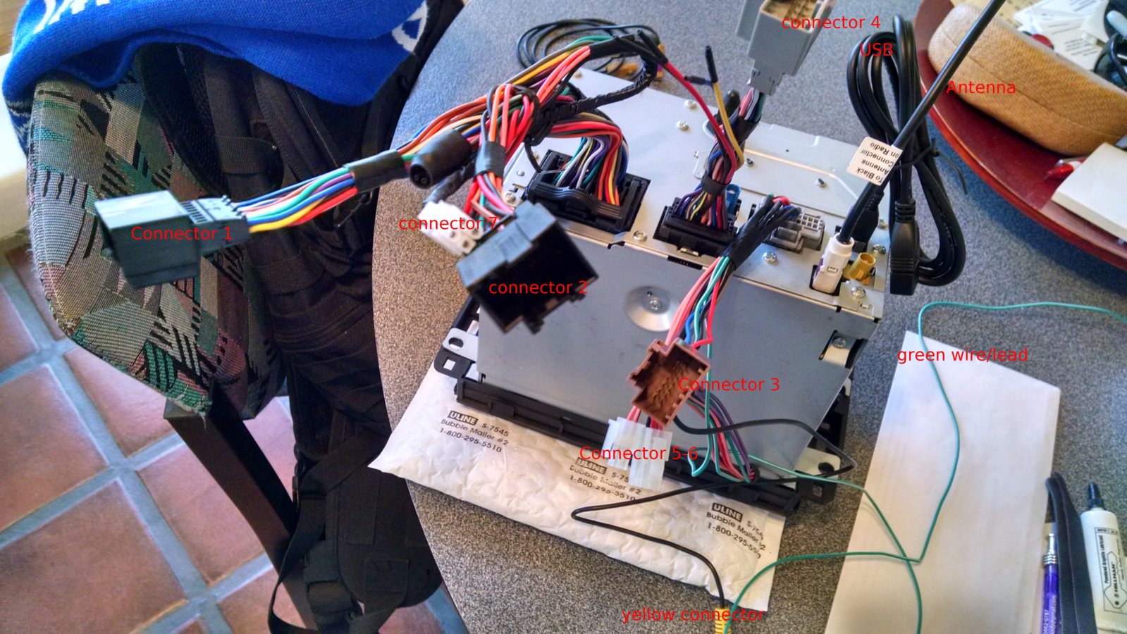

I realize this is a really old thread, but I have a 2013 Tahoe SSV and bought/installed a GM OEM Nav-Radio for it. I was told by the shop that re-programmed the radio that I had to use a pac1416) for it. (https://www.ebay.com/itm/NEW-PAC-AOEM-GM1416-Buick-Chevrolet-GMC-Amplifier-Add-On-Interface-4-Channel-RCA/152793013770?ssPageName=STRK%3AMEBIDX%3AIT&_trksid=p2060353.m1438.l2649)
I can see how the plugs work on the 'input' end. What I am wondering about is, how do I hook up an amplifier (and what amplifier). The console I have is from a 2011 Silverado and has a Bose amp (can it be used?)
Is there a write up on how to do this (also, in a way that it keeps all the chimes etc)
At first I thought there would be a wiring harness to hook up the console amp to the radio, but I can't seem to find an OEM GM one.
I'll attach pics of the back of the radio and what I have in the console.
Thanks,
Ron

View attachment 192764 View attachment 192766 View attachment 192767 View attachment 192768
I would say stick to an aftermarket amp as it will be alot easier to add in. SSV might not have the center console wiring and the stock bose amp uses gm lan as a wake up so even if yo had the center console wiring it would still be missing some other wires that the stock amp uses. so in the end its more work then its worth.
