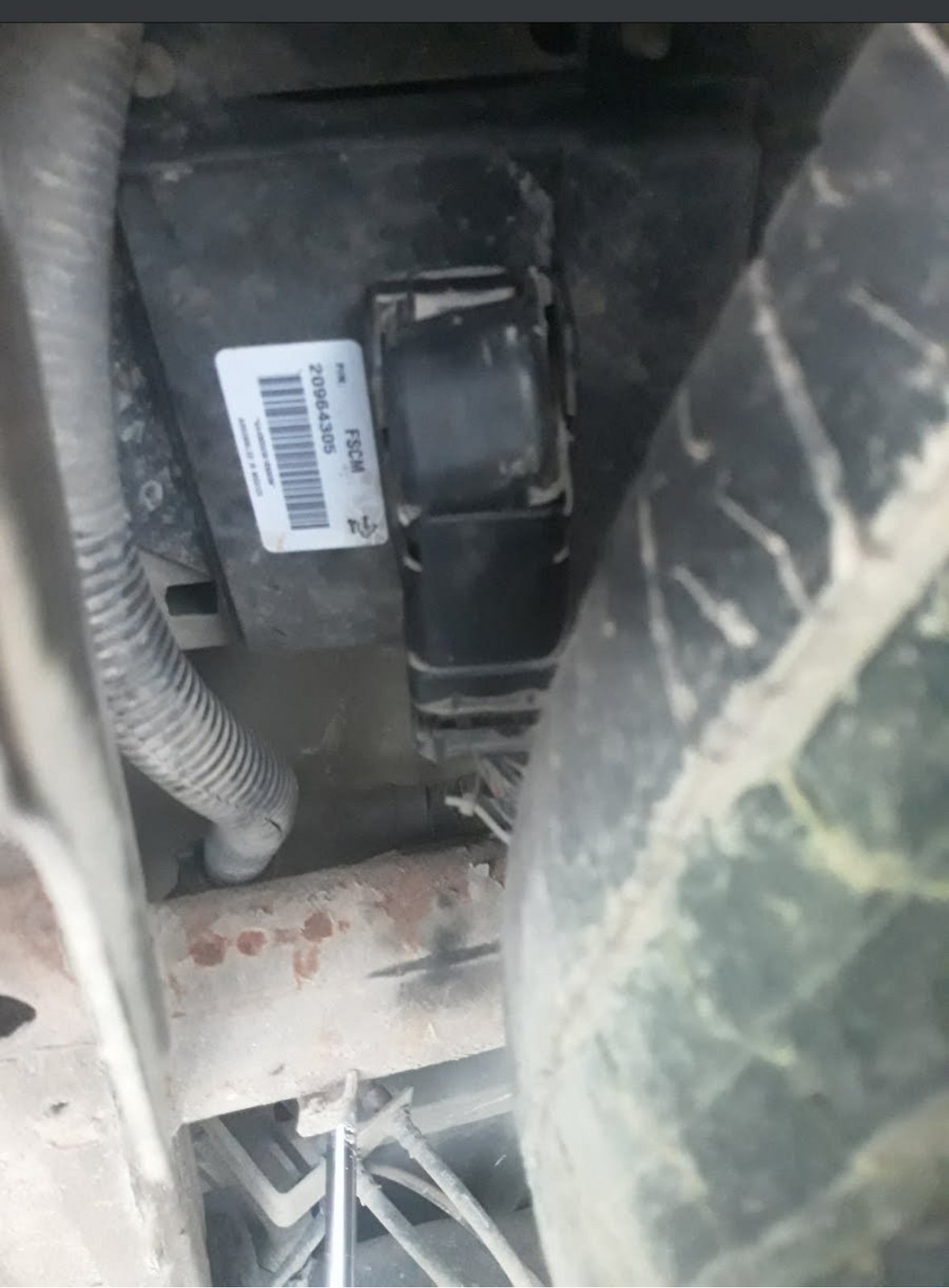

Is this the fuel pump module or something else?

if you have the active system like air bags and or z55 shocks, that should be the module for that back under the spare tire
Oh ok this must be whats there then. Thanks alot. I also wasnt aware 2007 didnt have a fuel pump control module
