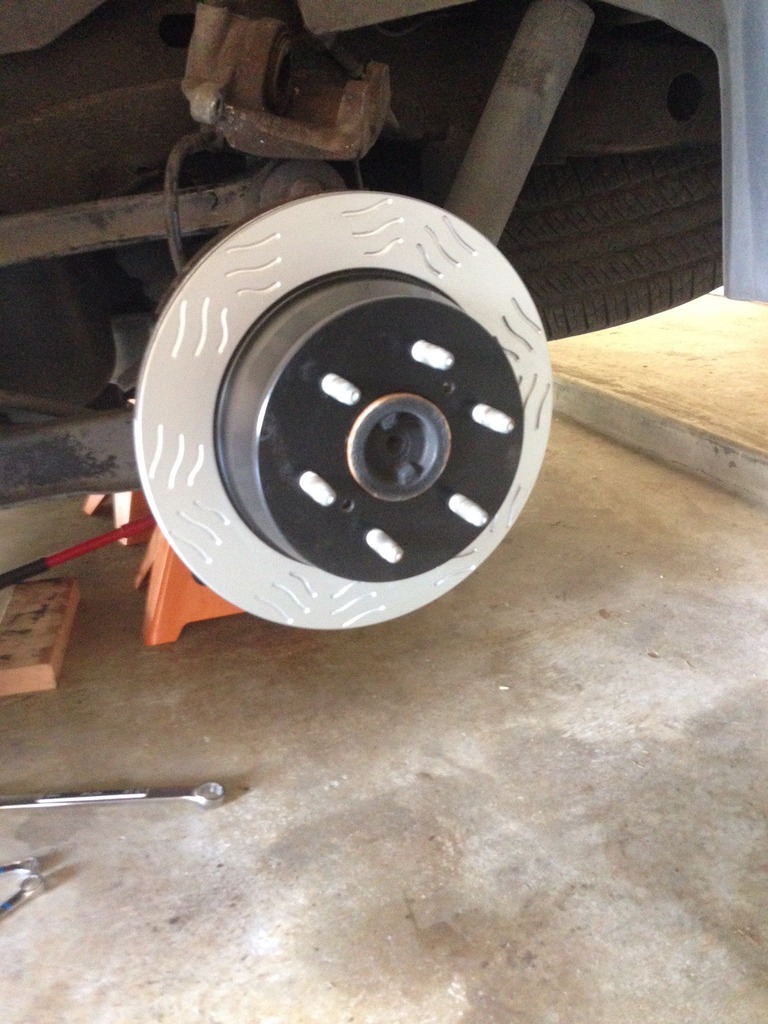

OK, I looked very hard at the Wilwood & Baer systems, but did not think I would need this much braking as I am not going to do much more than some acceleration bursts and a bit of spirited driving around the hill country here in Texas (and Alaska next year)
So after a lot of research I am going with the Raybestos EHT Hybrid pads, which are Semi Metallic/Ceramic and the PER-300 Rotors F&R.
These rotors have degassing slots on the rotors and no drilling of the rotor. They do have a "Better PPV Rotor & Pad", but I did not want to deal with the dust of a pure semi-metallic pad like the EBC stuff I tried and took off.
I actually called and talked to one of Raybestos" engineers and he explained the metallurgy differences in the EHT & PPV rotors, which is what helped make my decision to go with the EHT products.
I looked into buying the AC Delco Specialty Performance Rotors as they are the Raybestos EHT product & I get jobber prices from a local AC Delco parts house. It is a bit odd though as AC Delco buys the rotors from Raybestos but uses their ceramic pads and not the EHT pads. However they could not match Rock Auto's price even though I get Jobber pricing.
All of the EHT products are available from Rock Auto and get our 5% discount, so I am going to order all of the parts at one time and get what I think is a good deal.
Total for F&R EHT rotors & EHT pads is $476.59 including freight & no tax.. I can not get that good of a deal from my local parts house using the AC Delco part #.
Anyway, that is what is going on my 6.2L Tahoe..

Did you think about replacing your front lines with stainless steel ones? I just ordered some Power Stop K2070 for all four corners, ATE 706402 Original SL.6 DOT 4 Brake Fluid and 950.66002 - StopTech SportStop Stainless Steel Brake Lines.
I am hoping this setup yields better breaking than stock, I will know by the end of next week.

The per-300 are Chinese rotors FYI and the EHT pads are as well.

Yep, I found out that the Raybestos are ***** so will not be using them..
And Fiatdale, it is Wilwood or Baer.. I used Wilwood on all my race cars so am partial to them..
Back to the drawing board :)
Been too busy to deal with the Tahoe, so that turned out to be a good thing.. Now I will have the time to put some work into it...
Thanks for the heads up..

Choo Choo-- thanks for the review.. I have always known Wilwood's are great, so that is the way I am going..with Wilwood pads on the rear. I already have the SS hoses sitting on the shelf.
Running factory 20" wheels so the 16's will fit..
Also going with the Goodyear Eagle Sport V rated tires..
