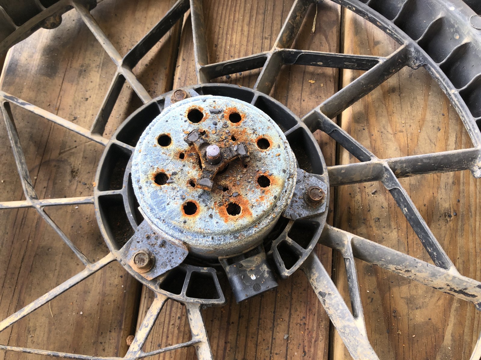

There are a lot of videos on youtube of people changing this fan assembly out for a new one. I see electric motors in fans and other applications a lot and in the same type fashion. Intermittent start but help it spin or tap/slap it and it will start. Here is the video I used for installation instructions, he's having same symptoms. Overheating, no a/c, no fans.
I have checked the connections, they tight and don't look bad. And also that wouldn't explain why it starts fine when I give it a smack.
This is what I ordered, 9 and 7 blade from 7 and 5. Who knows if that makes a difference but it was priced nice on Summit, was like 70 more on amazon and eBay. https://www.summitracing.com/parts/FSS-76016

we have gone over and over on fans on the forum for years, you are the 1st that I know of to report such a problem, guess there is time for everything to happen.
the only other thing I can think of that would cause the fans to not spin up properly beside simply being bad is from not enough amps.
if you still have the same issue after replacing the fans that would be one thing to check.
I did upgrade mine from the 500w oem to the 750w oem and when I did that I put in brand new motors simply because it made sense not because of any known issue with them failing I bought the shroud used out of a hummer and just had no idea how much they had been used.
in his video it looks like he put in tyc I wouldn't recommend them myself I have read to many reviews of them failing.
