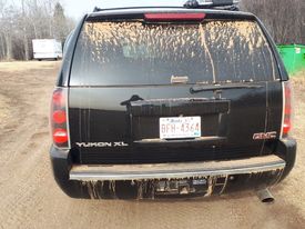

Hello all. I had mentioned on a different thread I would make a post of the "mini makeover" on my 2014 XL Denali. Its my wife's main DD and we live on gravel so it has had a rough few years, Rockers and lower doors/wheel wells are all rock chipped and starting to get a bit of surface rust, rims are peeling, windshield is smashed, brakes are squeeling and fake chrome is peeling/pitted. It was a long Alberta winter for this poor girl.
I had 10 days off and planned to spend most of that time on this thing. Obviously having to use some of that time for other commitments.
Here are some before pictures. Hopefully this works..

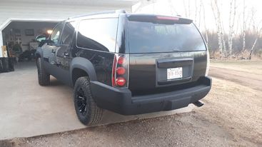

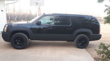

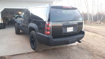

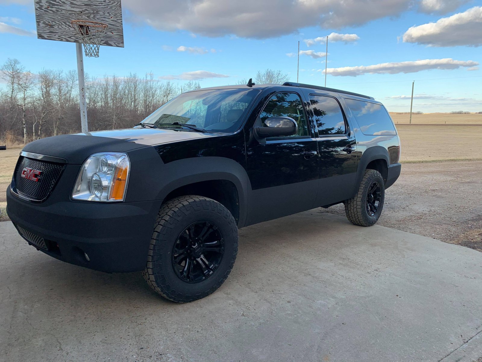

I removed everything I could get to and prepped for paint/primer. I took all rock chips down to bare metal and used an etching sealant. On the chrome (and fake chrome) I used 80 grit and roughed up then sprayed with two part epoxy primer before using color matched paint or Raptor liner. I used a 2k clear after any paint.
Without getting into too much detail, here is what I have done...
-Raptor lined bottom and outer frame rails and rocker bottoms, roof rails, rear trim, both bumpers and bottom of body, lower door jams and bottom inside of doors. I also removed the alum "Denali" sill inserts and lined them too.
-Removed and repaired rear applique (stripped bolts)
-New brake pads all around
-Rear wiper delete (we never use it as it scratches the window with our dirt)
- 1.5" rear and 2" front level
- New Drag links
-Removed air dam
-Color match and 2k clear- grill, grill surround, top trim and door handles
-New windshield (I had this done at a shop)
-new 18x9 rims with 275 70r18 cooper tires

That looks awesome. How difficult was it to spray the raptor liner?
Spraying wasn't hard at all, much easier than paint. When it first dried there were faint lines in it, that kind of freaked me out because I hate that about liner paint jobs but once it dried it was perfectly uniform with no lines. I pulled masking after an hour and it pulled clean with no lifting.
