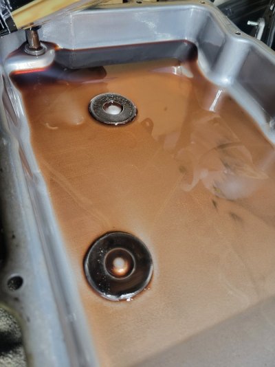

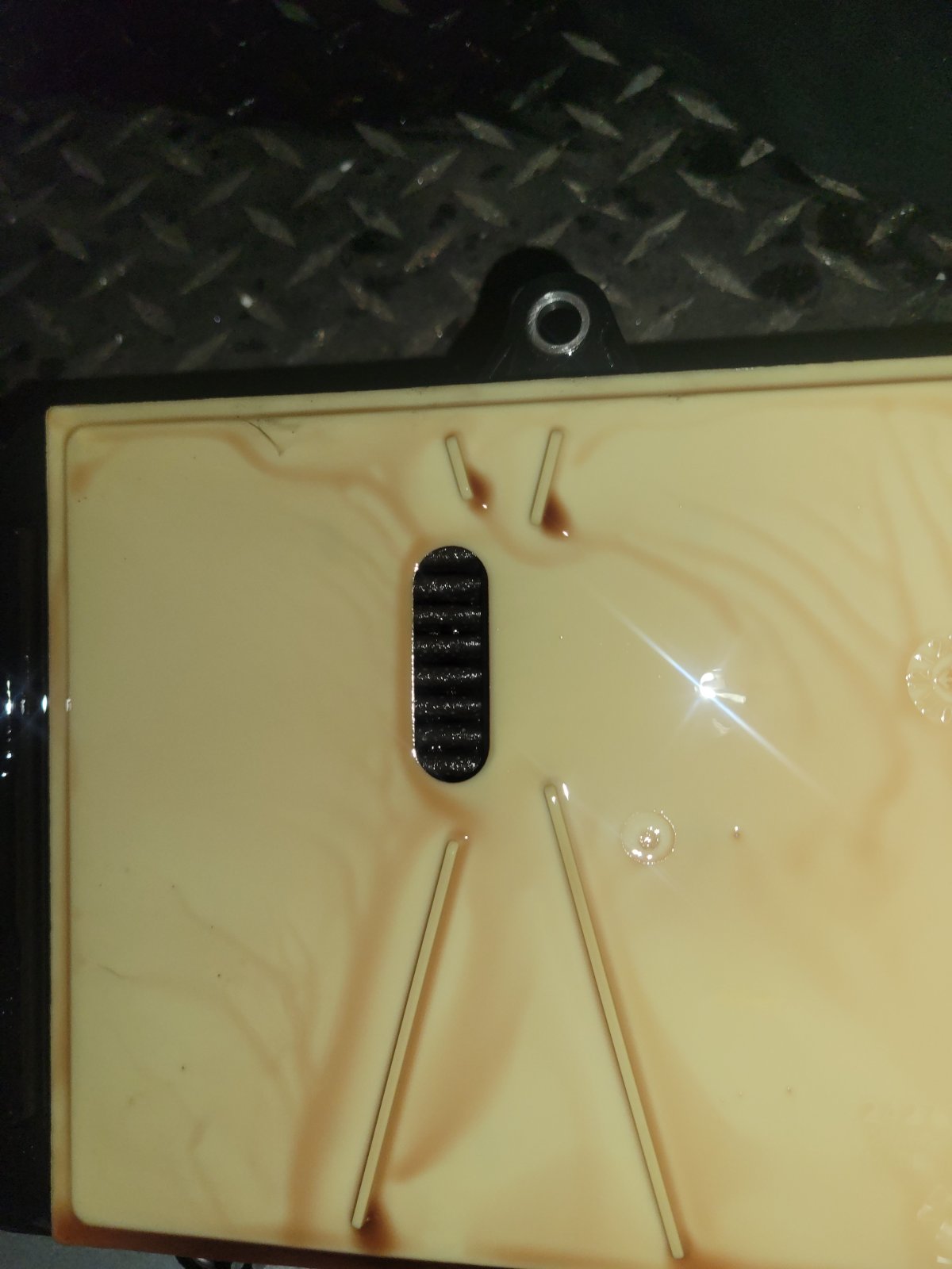

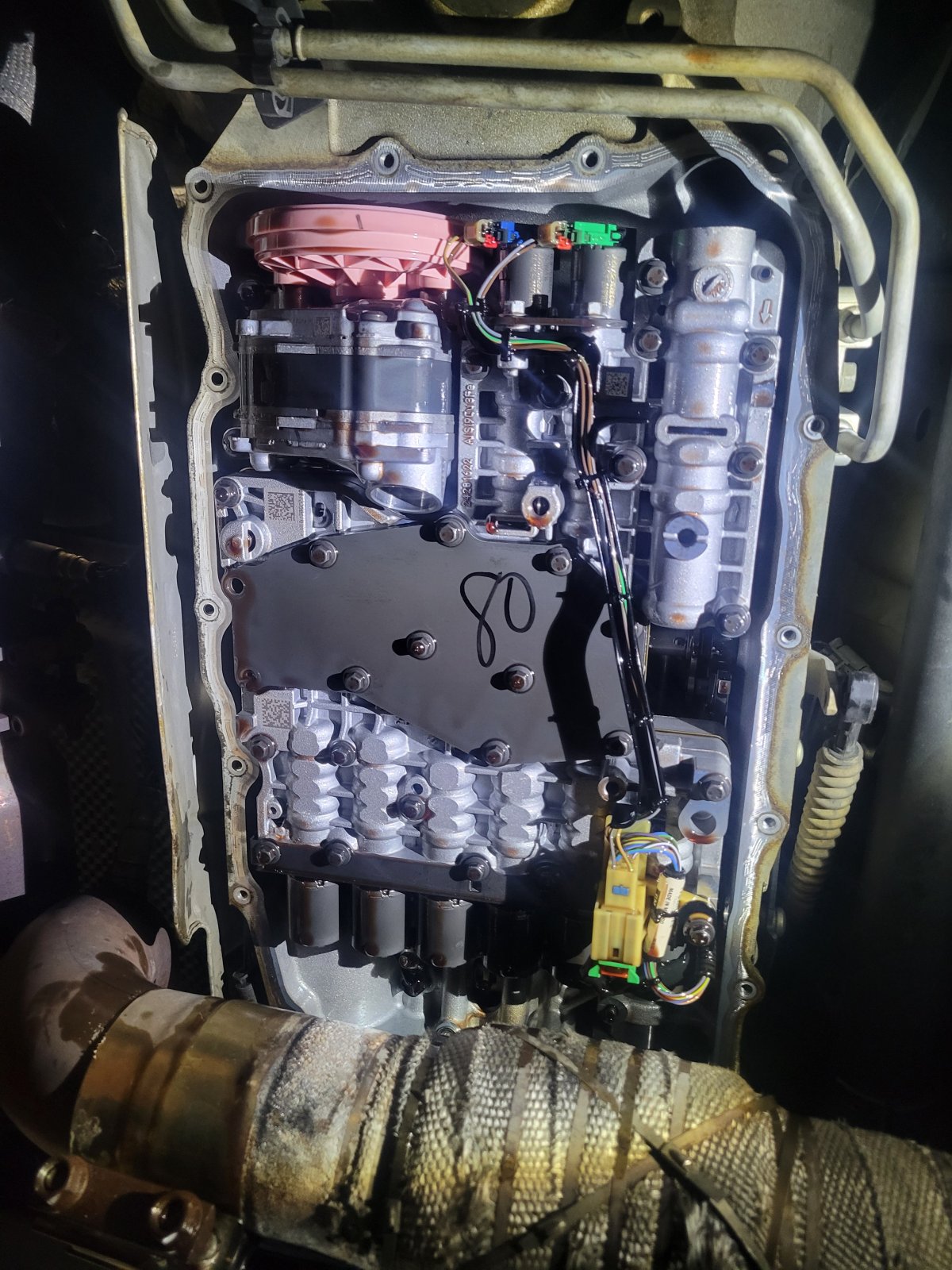

Now I'm getting code p0777, valve body solenoid b stuck open, and a tcm related code, u0101. I pulled the pan and there's minimal shavings on the magnet, no chipped gears or anything that strikes me as major damage.
I've reached out to various local dealers and transmission shops, and there seems to be a long lead time for a new valve body. So I'm looking for repair/replacement options for a valve body's solenoid(s).

I haven't actually begun working on the 10 speeds for GM and Ford as of yet but planning to start this fall. That said, I'll have to take away the above and research it a bit. See if there's an obvious solution(s) that don't involve a full overhaul. False neutrals are usually indicative of internal-to-the case mechanical failures however in the eight and 10-speeds, they can be valve body, solenoid and/or TCM related. We would want to start with the easiest / cheapest causes first then rule them in/out before thinking about pulling the transmission.
I'll reply later today or early tomorrow with something...

Thanks! I read somewhere else what the family of _L80 transmissions might all use the same solenoids? I skipped work and checked a couple local salvage yards today, but no luck finding a donor.
So I think the next cheapest solution would be to keep looking for a used transmission to salvage a solenoid from. After that, the Sonnax or Next Gen rebuild kits. But that would be assuming the solenoids are functioning electrically and my issue is mechanical.
For now all I can do is drain the fluid again and disassemble my existing valve body, and individually test the solenoids.
