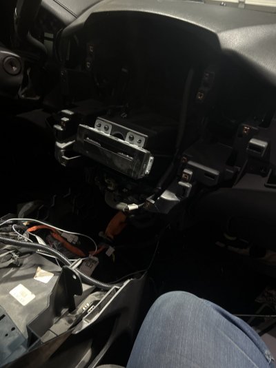

I got so excited man. Spliced them up like this for now but it won’t honk.
I still cannot find mine
Do you have one tagged 6J4? If its a single pair of wires (in the same loom) that are cut/ open on the end, then splicing them together should make the horn work. The upfitter manul says that pigtail is in the under dash harness, but mine was in the pigtail between the seats.
This is what I had left when I removed my console, lol:
i can’t find this pigtail was yours under the center console or closer to the firewall ?
Thank you so much!! The way you described the "pair of wires (in the same loom)" finally got my to realize I wasn't looking for something in addition to this to connect them to but that it goes to itself. I going the 6J4 and thought I would be able to do it but with anything to connect it to I was at a loss, but never would I have thought it would just need to be connected like this. My 2019 PPV Tahoe horn is all good now, I was hours into this and I couldn't have done it without this post
