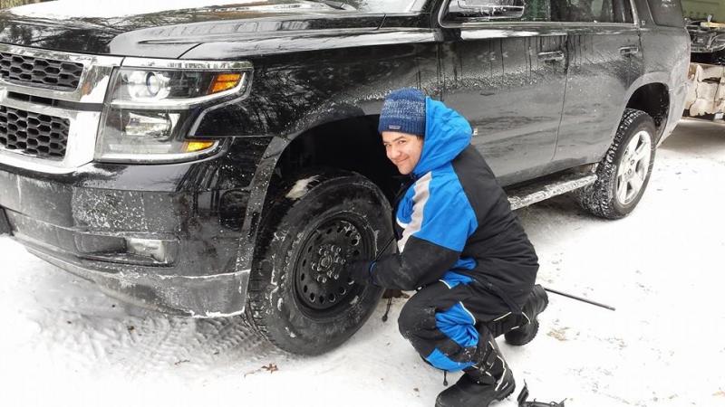

I finally got the leveling kit on. We ended up going with a 2.5" front & 1.5" rear suspension maxx leveling kit. Suspension maxx was one of the only ones I could find that had a product for the '15 models & they seem to have a good reputation. Seems like a good kit & the install wasn't bad.

I felt like it was worth the extra money since it is made in the USA. I did install it by myself & it took about 4 hours.

How did you get the ball joint apart at on the end of the top A-arm? I have it all apart and can't get it pried down far enough to put the shim in. I know I have to pop that ball joint but how?
Thanks! My truck is torn apart and I need to get it back together for the morning.

You have to hit it pretty hard with hammer to break it loose. It took a while for mine & then all of a sudden it was free. That was probably the hardest part of the install which wasn't too bad.
Damn it's a beast! Looks good for sure man.
Thanks. We're loving it so far.
