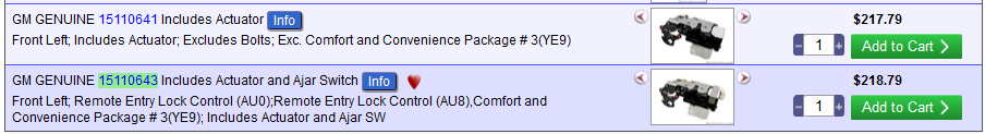

From Rock Auto for a 2002 (the actual latch varies depending on the options):
This site also shows some variations, be sure to scroll down. I think there are three shown for the driver's door, but I didn't look at them very carefully: https://www.gmpartsdirect.com/v-2002-gmc-yukon--sle--5-3l-v8-flex/body--front-door

Your title says 2000 MY; should it be 2002?
Yes 2002, fixed the typo. Good catch!
Thanks a lot for this. Ouch, these are expensive.

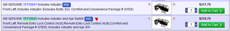

I found some lower cost options.... I'll need to call the dealer and get the part number for my VIN and see which one I may possibly need. GM part would be nice, I always buy NOS/OEM parts but at 8X the cost it begs the question
