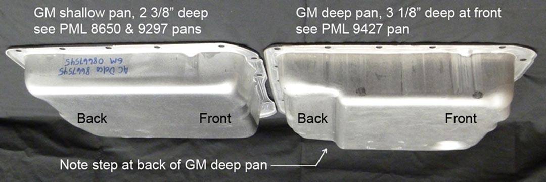

When you say has a step in it, what do you mean?
Step pan...
No Step pan ( flat bottom - not two levels)...
These are jut an example. The step pan has a little step in it and needs a deep filter to reach the lower level.
