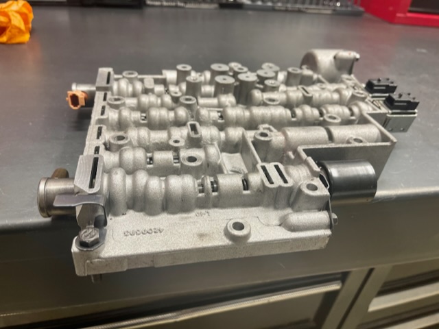

A dipstick stop is used on models up to 2003 then the pan changed in 04+ to include a step/shelf in that location that performs that function. The dipstick stop for a shallow pan is a little shorter/shallower than one for a deep pan (97+). I don’t have dipsticks from shallow and deep pan vehicles to directly compare but id suspect they may not be exactly the same length given the difference in height between the two stops.
Shallow pan example
Deep pan
