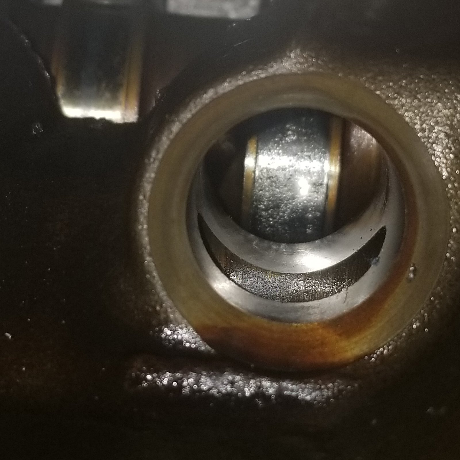

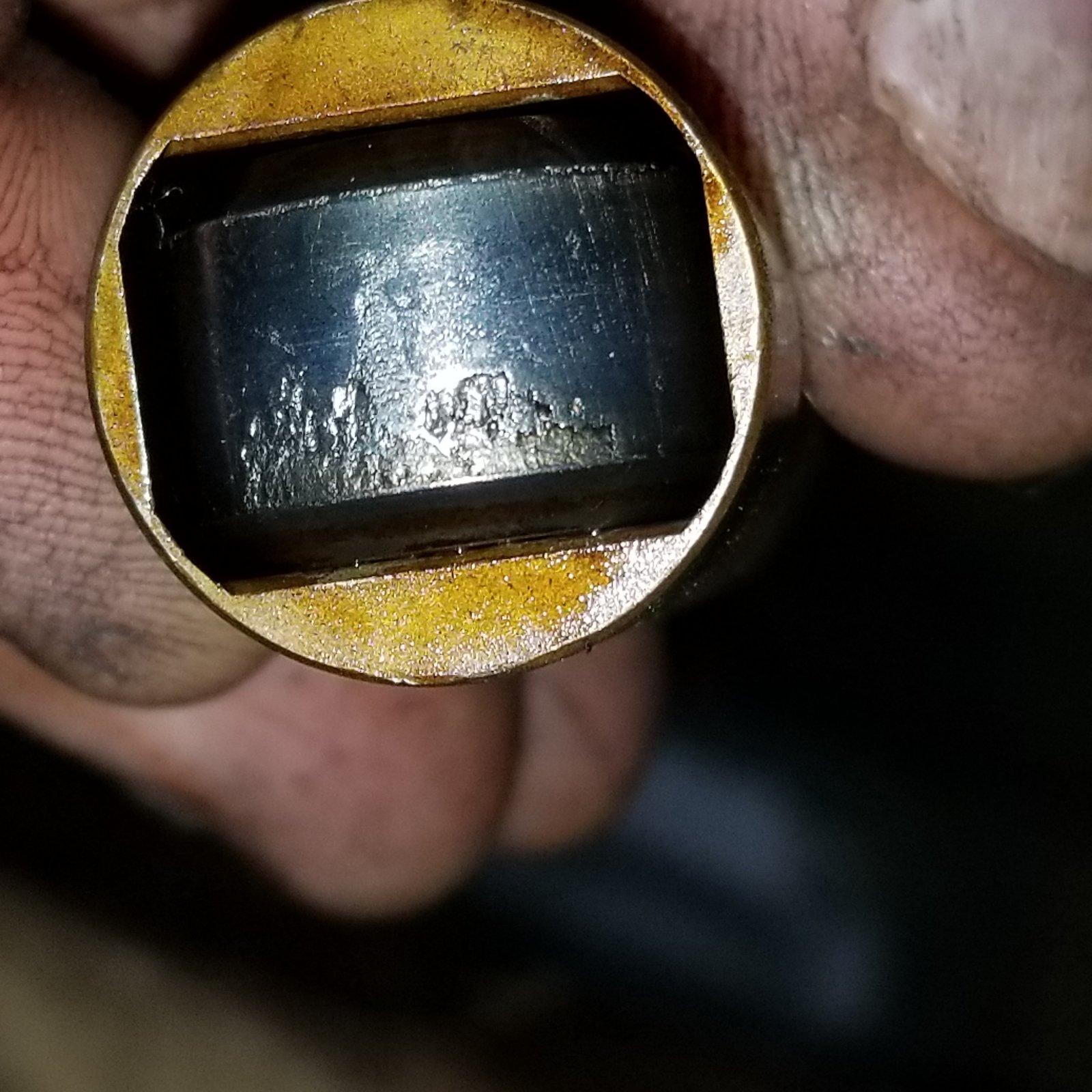

I got the passenger side head removed and the misfire and ticking noise is the #2 cylinder liter. I have to remove the camshaft and replace it. When removing the head I did not see any dowel rod pins to reattach heads and keep from moving all around in reinstallation.
Besides removing the Fan, Fan shroud, Radiator, water pump, bellhousing, timing cover, timing chain and timing chain sprocket it looks like the cam pulls out the front. I am going to remove the driver side head this coming weekend. Once all the lifters are out and the motor is at #1 cylinder, TDC does the cam slide straight out or do you have to turn camshaft clockwise when removing to pass internal parts.? I saw a youtube video where the person had to turn camshaft to remove it from the front.
What camshaft do you prefer or replace it with, Gm? What is the preferred engine assembly lube for reinstalling the camshaft? Do I need to remove the valley pan cover to inspect the camshaft bearings?
When I removed the scorred lifter I noticed that one was sitting about 3/8" higher than the other 7 lifters. I can sit the lifter on a metal table and move the roller side to side and I can hear almost the same sound as when the motor was running. On the bottom of the roller it is not scorred completely. It almost seems to me the lifter/roller moved up off the cam and turned 90 degrees. Instead of the roller moving the way it was suppose to instead the lifter was dragging/scorring the camshaft. I noticed the Oem lifter tray does not lock the orientation of the lifter in a locked place.
Also my oil pressure was 40 at idle and 55 at 60 mph. Should I be concerned with the metal fragments getting sucked into the oil pump? Should I replace the oil pump and if so do I have to removed the motor to remove oil pickup line in oil pan or is there a work around?
