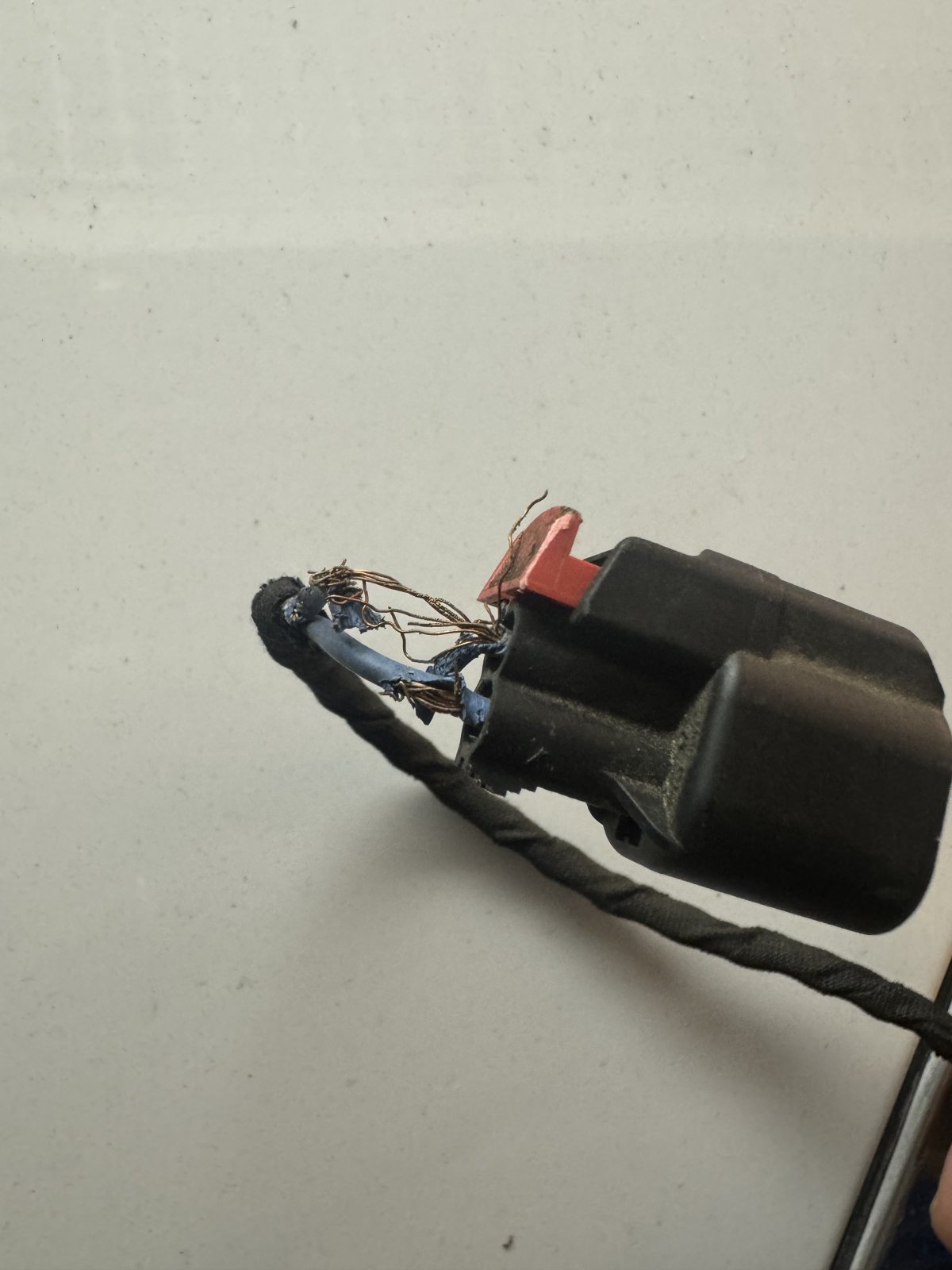

2017 GMC Yukon 5.3L with 72k miles developed a tick very recently, noticeable sluggish performance but no check engine light. As I researched I discovered the dreaded collapsed lifter issue, read a lot, watched lots of videos and have my parts list compiled to get everything ordered. A couple things keeping me from moving forward with a lifter job…
As I worked through diagnostics I noticed a rodent had chewed into the fuel injector wiring for cylinder 2 pretty bad. Getting that fixed was a must and I read that injectors can tick so I replaced that harness but the ticking persists. One noticeable change after replacing the fuel injector harness is that when starting the engine initially idles fine, although still ticking, but slowly starts to bog down after 30-45 seconds and have a rough idle. Before the repair with the chewed wire the idle was consistent, without bogging down. I’m not sure why the repaired harness would cause that behavior?… in any case is it possible the injector wire shorting caused an injector to go bad and is it possible that might be the ticking sound?

I’ll check the manifold. As for the harness, I replaced it with a new one… it’s a small piece, part 12707877
